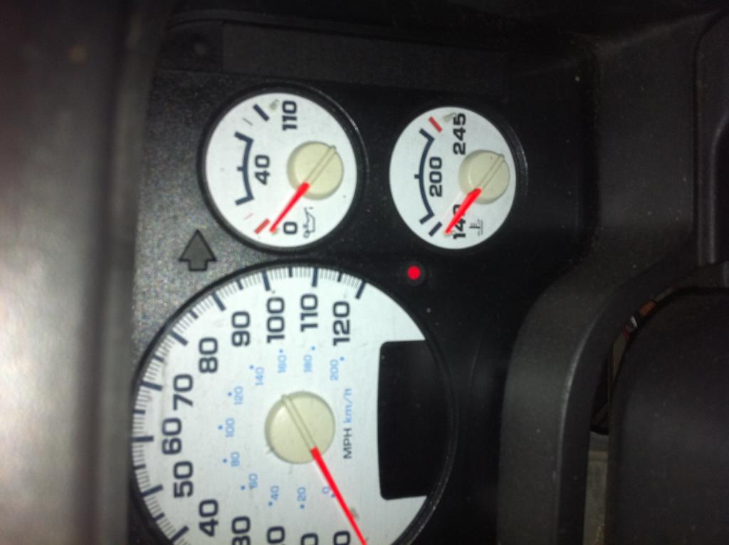

Anyone know what this light is on my dash? just to the left of the temp gauge?
When the truck cut power to everything (Litterally EVERYTHING! No lights, no horn, no hazards, NOTHING)
This light would be on solid with the key on, with the key off it would flash consistantly for a period of time (20 minutes or so) untill it slowly stopped completly and stayed off.
Ive never seen it before and have never heard of it from anyone.

Old Mar 15, 2011 | 11:32 PM
CatDiesel_762's Avatar
Posts: 398
From: Gillette, Wyoming
That red light is your security system indicator. Check your owners manual for more information as to what it means when it is on constantly. I would say that your batteries were bad. I have replaced two Die Hard Gold Batteries in the last year twice. One was under a week old too.
Shawn
I have a security system?! Hum. I bought the truck used and wanted keyless entry. I took the truck to the dealer to have them research my vin and they said my truck had everything available for an 03 except keyless entry.
Now I'm gonna have to rip the dash apart to find a little black box

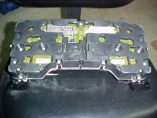

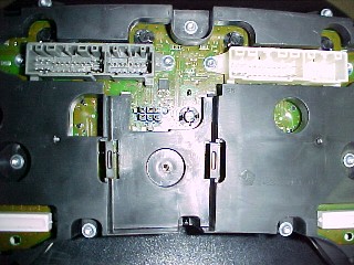

Old Mar 20, 2011 | 04:25 PM
Nascarcamper's Avatar
Joined: Sep 2004
Posts: 434
From: Metamora, MI
Right here it would be. PM me if you want step by step instructions for removal or need it re-programmed without paying the dealer price.
Attached Thumbnails What could cause this? (pic)-clusterback.jpg   What could cause this? (pic)-modsocket.jpg
