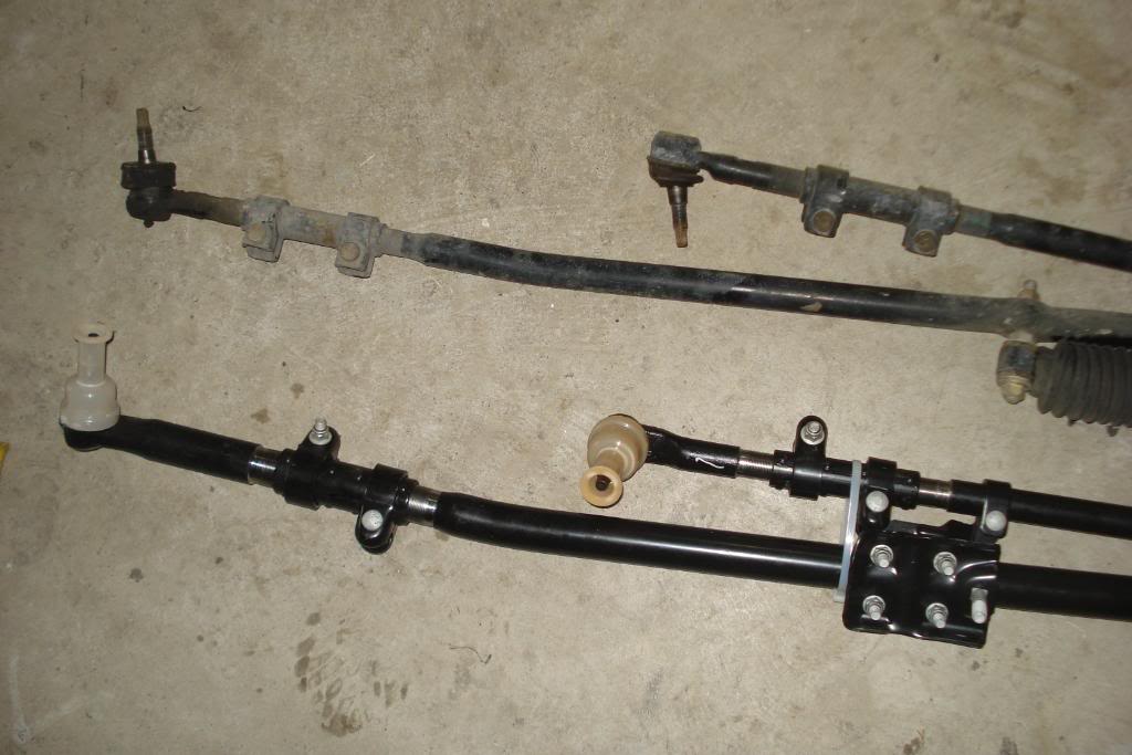

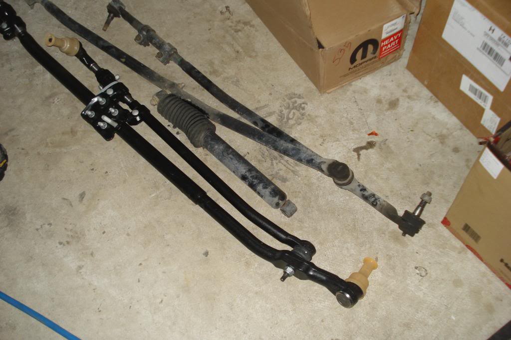

With the upgraded Mopar Steering kit.....you will have to replace the pitman arm and steering damper.
As far as shocks, track bar, coils etc....you can buy that from KORE, Carli, Lorenz or Thuren etc.
The steering kit is not an aftermarket item, I don't think.
When I upgraded mine recently, I installed KORE 3'' coils (removed HBS 2'' leveling kit), new end links, hubs, Dynatrac ball joints, Bilstein Shocks and Steering Damper.
Here is my 04.5 steering vs. the 08.5+ steering.

TxCTD you're correct. The steering linkage is not aftermarket. All Mopar. Thurens stuff is a crossover setup.
I put the AF and new pitman arm on my truck after an outer tie rod blew out on my stock linkage.

Upgrading the steering isn't just a way to get rid of money that's burning a hole in your pocket, it's a way to make your truck steer way better, prevent or stop DW, and generally make it safer and stronger.
EVERYONE with a pre-'08 truck should be installing the '08 linkage. It's a better design and it's stronger. Also important is fixing the track bar by either replacing it or installing better bushings in the stock one.
