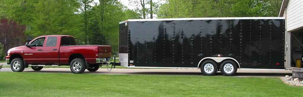

That looks like a nice trailer. Mine is a 22' +2.5' V, I use it to haul a 3800lb car and I get 11-12 mpg at 65-70 mph. How much weight do you put in the trailer? Your cummins will definitely pull better than your previous trucks but mileage won't be a lot better, just a little. I've also hauled this car on a 18' flat bed trailer and got 14mpg.
I load up with about 40 5 gallon cans of striping paint @ 70#'s per can so....2800#'s of paint plus three striping machines at 250#'s each and some assorted paraphenalia....
4000 Pounds of stuff. Trailer wieghs 2200 Pounds. I swear I will be very dissapointed if I get 11 MPG....Arrrgh.
My prior attempts at pulling a 100 Pound cargo trailer with 1500 pounds of stuff netted me 9-10 MPG going 75+ non-stop with the AC a blastin'.
I almost didnt even bother posting this issue her in the first place but figured since we all have Cummins powered trucks we must be pulling something right? Excellent advice so far Gents I thank y'all for the insight!!
