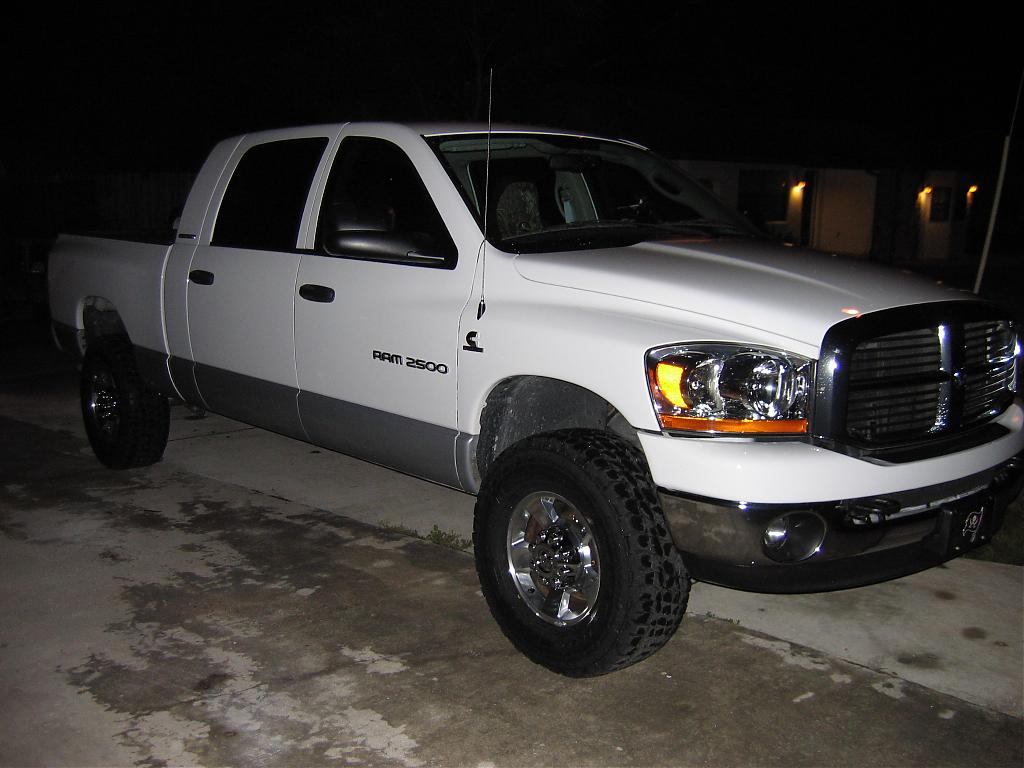

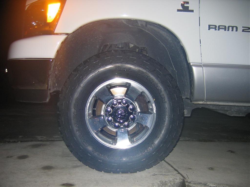

I just had a set of 305/70/17 E rated 10 ply TG put on my stock wheels this afternoon. 8" is the min width on these, 33.98" diameter. Right now I've got 52 pounds in the front and 45 in rear and they have just enough pooch to notice, 65 is max. They ride as smooth as stock if not better. Takes a little more brake pedal to stop. Speedo and odo are off. No rubbing and they stick out of the wells about 1/2". They fill up the wells nicely too almost as good as the 315 BFGs.
I'll try to post some pics.

Here's some night time pics just after it rained so the lens was a little foggy. I'll get some better ones soon.

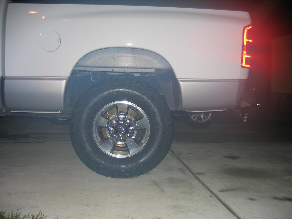

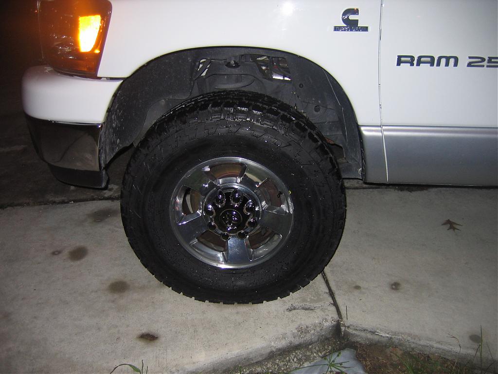

couple more
Only down side I've noticed so far is they have a little road noise to them. Other wise I think they're great.
