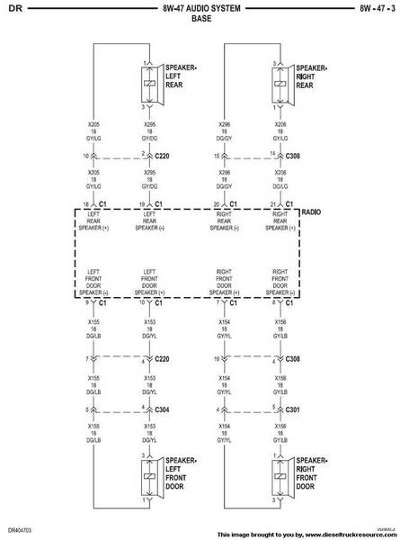

If you just replace the stock speakers do you have to match impedences or resistance or something? Are the standard factory speaker wires marked somehow for polarity?
Old Nov 3, 2006 | 08:48 PM
Pooter's Avatar
Posts: 2,627
From: DFW, TX
I have the diagram saved, ill post it when I get back to the home pc, but its pretty easy, two wires for each speaker, cut off the factory connector, solder on the aftermarket one, piece of cake....
EDIT: here it is....
Thanks to handymantim....
