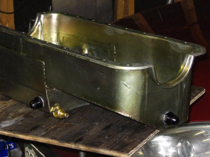

Originally Posted by elirandolph
Has anyone tested how high the threads stick up in the oil pan? I'm curious the fumoto leaves any oil in the bottom of the pan.
Of course, a lot depends on the pan you're using. This is ther pan from my race car. Like the Cummins, it has a large capacity, and the valve makes oil changes MUCH easier, and less messy.
This is the outside of the pan. You can see the Fumoto valve on the bottm left of the picture.

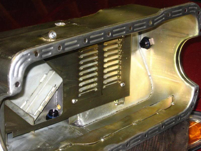

This is the inside of the pan. You can see the brass valve right next to the black AN bung.

Looks almost flush.
