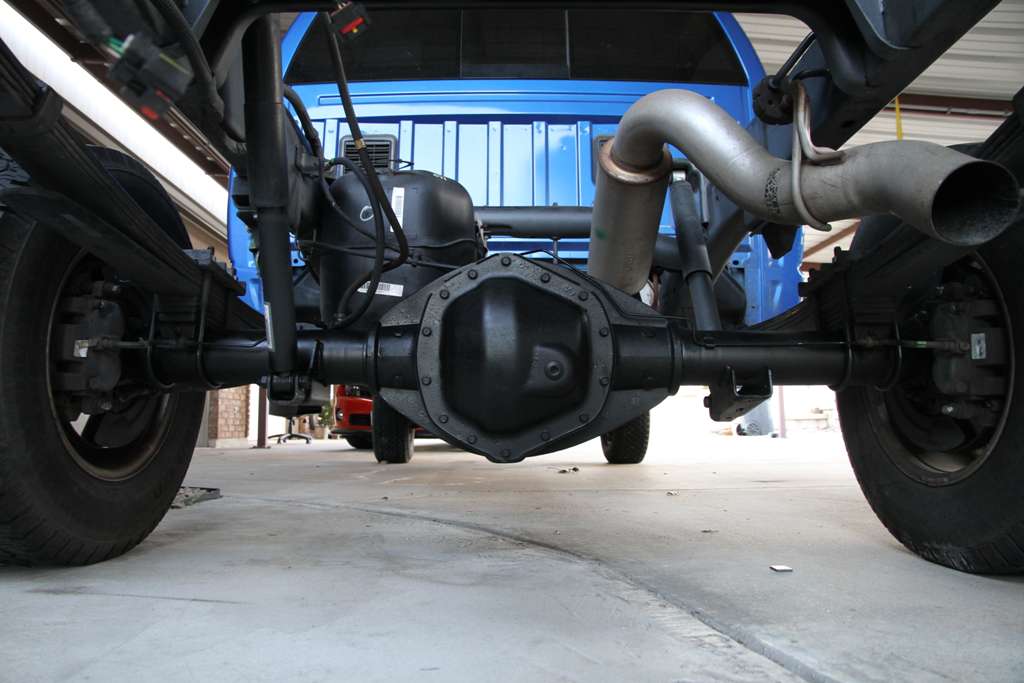

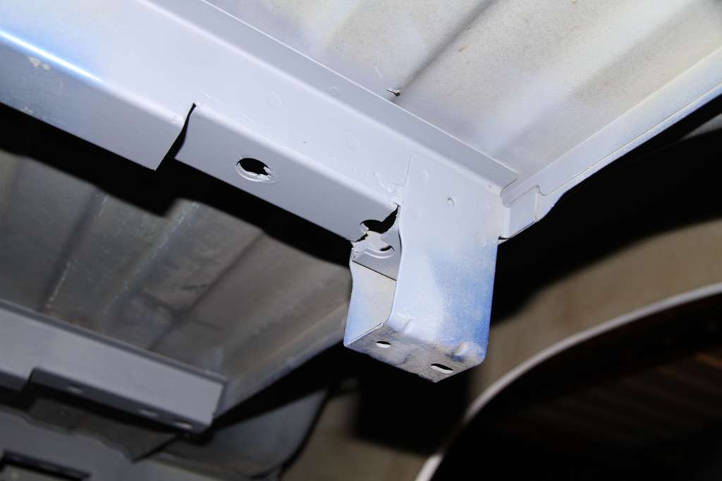

Update - bed ready to go back on!!!
So to allow me to align the creases in the bedsides perfectly with the body, I had to lower the bed about 1/4-3/8". Unfortunately, the only way to do it was to notch out the cross-rails that go side-to-side under the bed. Alot of work, but necessary. I don't like cutting corners The rearmost bed mount, right behind the bumper, is actually kinda complex, and so it was easier to notch the last few inches of the frame-rail that the bed sits on. I also trimmed a few extra mounts off (practice with the plasma cutter! ) that were for the original bumper and are no longer needed.
While I was back there spraying a little flat black paint on the new welds, I was looking at my surface-rusty massive rear differential, and thought, "what the hell...might as well paint it while the bed is off!", so about 5 minutes later, I have a rear axle that looks like it just rolled of the assembly line...actually, better.
Here's the update pics.
The bed and rails go back on tomorrow!!! I am also going to weld on the light mounting tabs and will snap a few pics with all of the lights on, though they will come back off before getting the truck sprayed. May get started on the front fender mounting tomorrow, too! Lots of progress this weekend!! My wife says I have to get it done!!

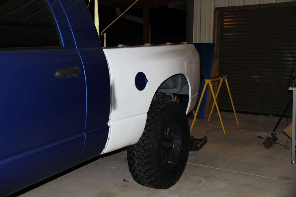

Wheels and bed back on!
Here are pics of yesterday's progress. Heading out now to do more work!
