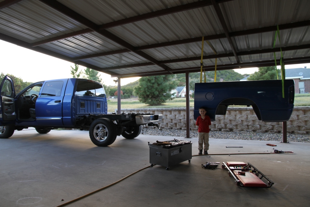

Very cool project indeed. I know it's the background but one of the things I'm interested in is your carport steel structure. That looks like its real nice to work under. How big is it?
The structure is 45x32'. Built it myself, and nope, I had never built anything like that before
It's far overengineered, but it was one of the best things I did. Oh, an my little 4 yr old helped weld it too!

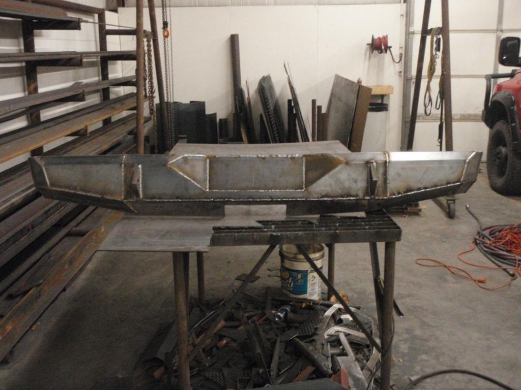

rear bumper update
Here's the progress on the rear bumper thus far. For anyone interested, here was my list of features that I needed included in the fab of the rear bumper:
-very low profile to optimize departure angle
-corner protection on lower edges of fenders
-5" rear facing lights
-high lift jack slots, reinforced
-provision for rear winch mount and roller fairlead mount.
-shackle mounts
-extra gusseting
-my personal shaping preferences
So here's the lastest snapshot on this!
Thanks again to Evan at backwoodsbumpers.com for his awesome attention to detail on this gorgeous piece!

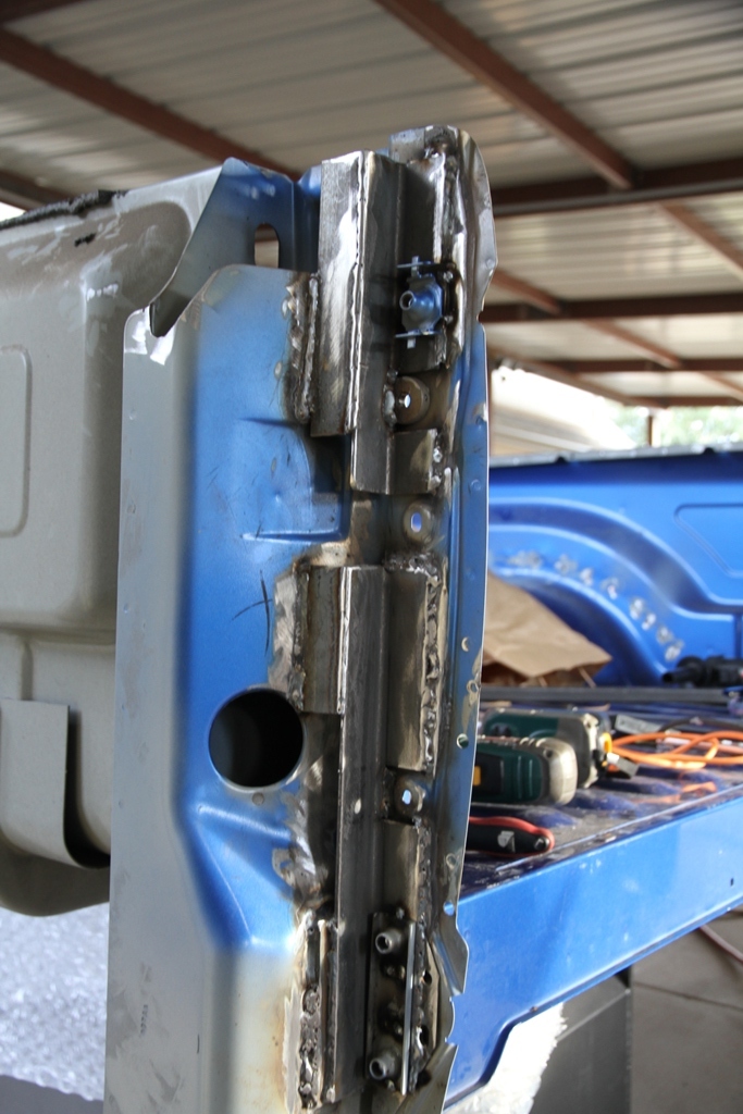

New update
I did a few extra parts of the fab this week, in between working crazy overnight shifts for the last 6 days.

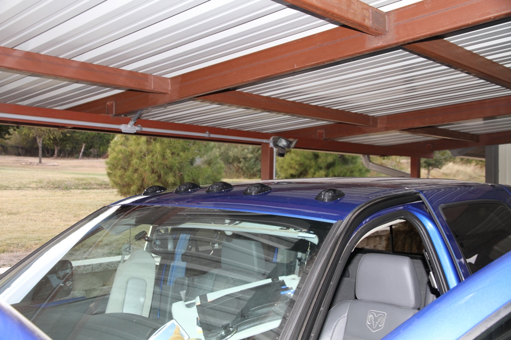

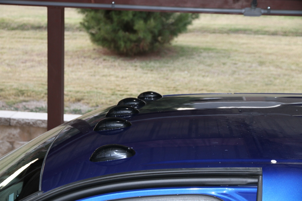

-Added roof marker lights (I needed a break from sheetmetal work!)

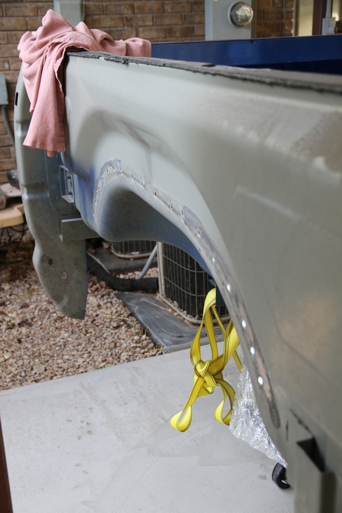

-Reinforced the rear tailgate mounting area to ensure Tiregate to be mounted later will not cause problems.
-Removed the rear inner fender liners (curved metal upper liner)
-Started minor corner reshaping to allow easier fiberglass fitment
The reinforcing part was kinda interesting because you have to piece together steel to take the flex out of the stock pivot flanges, but still be able to mount the outer skins AND the taillight housings....oh, and have room for the electrical connectors on the back of the taillights.
Here's a before and a few after pics...and a few of the roof markers.
BTW, I mounted my roof markers 2" further back than OEM. I liked the flatter sheet metal 2" further back which I think will help prevent any leak issues. The housings are flat, but the OEM mounting points are on a curved piece of roof sheet metal. I know it probably works fine, but I feel better with them mounted on flatter metal. And you can't really tell anyways
They are Recon LED models, so I shouldn't ever have to replace bulbs.
As far as the reinforcement I did around the tailgate - it's all 1.25" angle which ties the tailgate mounting flange firmly into the angled piece which is about 5 inches more towards the front of the truck. It is astounding how much more solid it is back there. Took ALL of the flex out of it. You have to put some thought into remounting the caged nuts that allow for adjustment of the tailgate pivots and latch pins. In the pics below, I mounted one of the taillights to show the fitment. If anyone ever needs to do this mod, I will gladly send the measurements of the required pieces of angle iron to construct this without affecting taillight placement.
Anyways, here's a few pics.
They are Recon LED models, so I shouldn't ever have to replace bulbs. As far as the reinforcement I did around the tailgate - it's all 1.25" angle which ties the tailgate mounting flange firmly into the angled piece which is about 5 inches more towards the front of the truck. It is astounding how much more solid it is back there. Took ALL of the flex out of it. You have to put some thought into remounting the caged nuts that allow for adjustment of the tailgate pivots and latch pins. In the pics below, I mounted one of the taillights to show the fitment. If anyone ever needs to do this mod, I will gladly send the measurements of the required pieces of angle iron to construct this without affecting taillight placement.
