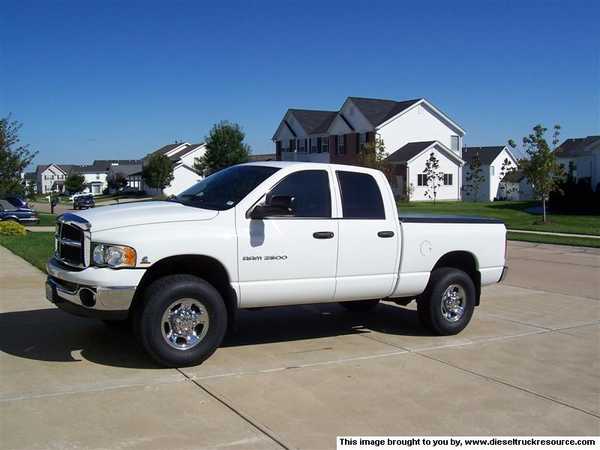

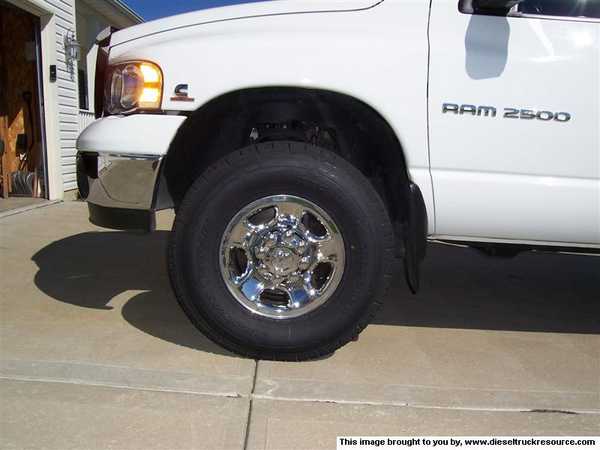

Here's the pics. The tire treads are even with the edge of the OEM mudflaps. The bulge of the sidewall sticks out past the mudflaps, but the treads are covered. There's a couple of more pics in my photo gallery, but these should give you an idea.
The tires are the same weight rating as the Toyo Open Country A/T (3970 lbs.). They are much quieter than the stock Bfg's, and I've aired them up to 70 lbs. each.

Looks GREAT & Thank you very much for the pic's & info.

Nice Dura Grapplers.
Real nice! Hopefully 35's are next!

These measure 33.8" - call 'em 34".
Close enough?
