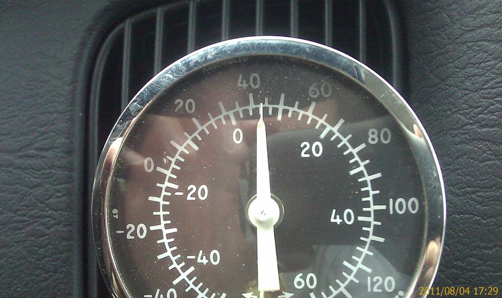

I ran it with the recert off and the compressor does not cycle. With the recert on it will cycle on and off. 85 outside. 1600 rpm. Try running yours with the recert off that may put enough load on it to keep it from freezing.
Not a fix but maybe better?
Attached Thumbnails Icing on Accumulator--need expert help please-acdodge.jpg
