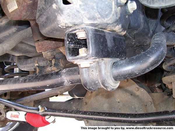

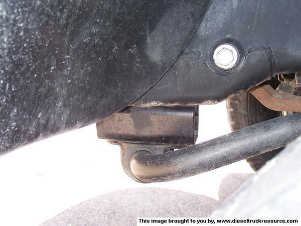

FWIW, I'm not running drop brackets or extended links on my rig and it's fine with a leveling kit. I've got a fairly heavy front bumper though, so I only netted about 1.75" from the new coils.
If you're going to replace them, I'd get longer ones vs drop brackets personally.
Before.
After.
