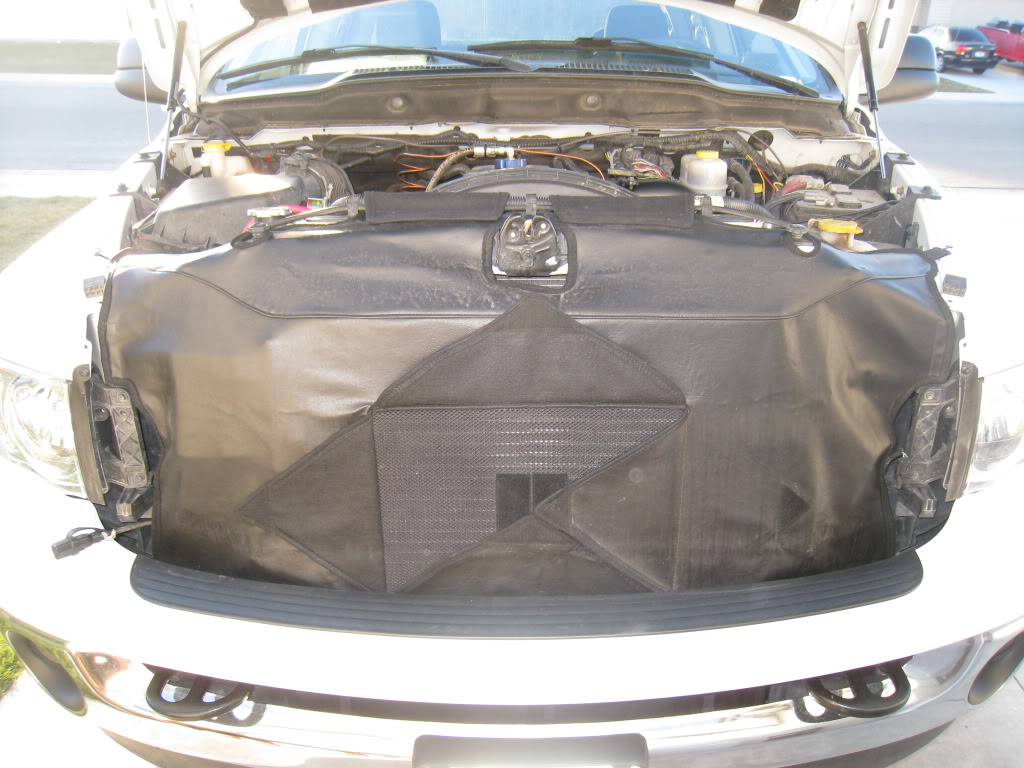

Is your winter front the same as the one from Geno's?
I got mine from Geno a couple of weeks ago.

I just looked on the Geno's website and mine looks different. Mine is the Mopar one.
