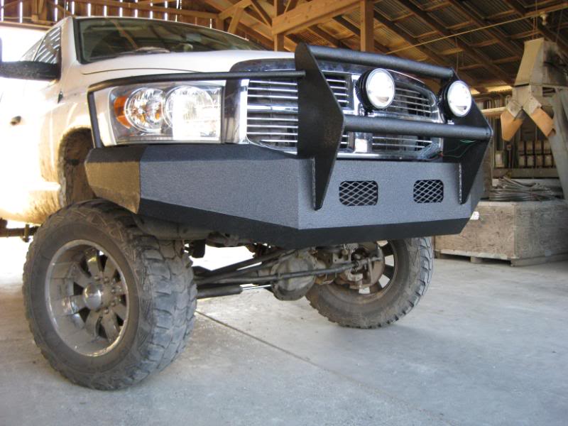

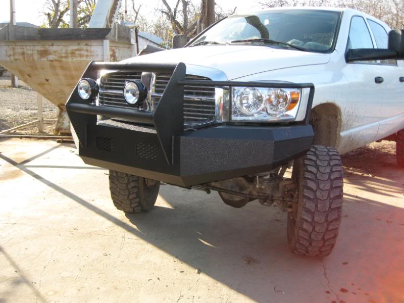

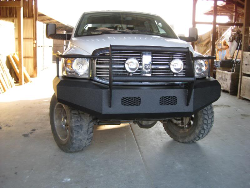

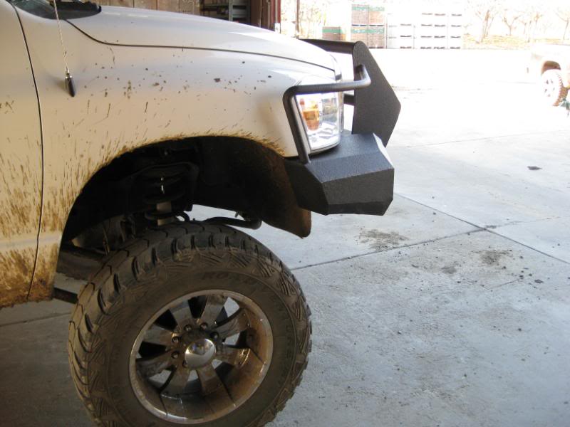

here is one i built a little bit ago, gettin ready to build a set for the mega cab i picked up last week, enjoy....

Very nice looking!! What is the thickness of the steel?
thanks! It's 3/16 plate, with 1/2 brackets and grille guard uprights, 1/4 on the grille guard tubes, and the light guards are solid stock

How did you get the bumper lines straight? Did you make a jig? Also did you make a mock up out of some sort of plywood or some sort of card board?
Great looking work!!!
every line you see is a cut/weld, the only template i made out of card board for the upper wings around the headlights, other than that i just cut and tacked till i got my angles for one side then copied it to the other
