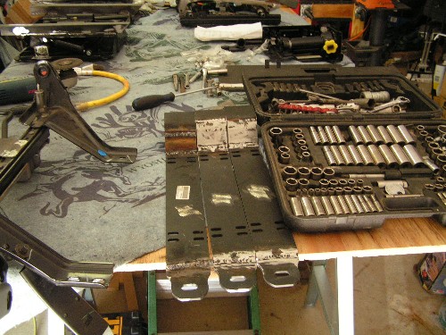

They were $714 shipped, that's both driver & passenger suspensions & the center console brackets. Remember you have to remove your seats from factory frame, grind off factory welded brad looking do hickeys, weld angle, drill holes & attach. I also modified the Industrial suspension brackets to drop the whole thing down another 1 1/2" down so I wouldn't be so high when inflated.

Here is the modified bracket
The main bracket was cut then 1 1/2" was added to it on the front, then 3/4" on the back. Flat steel bar is at Home Depot. This lowered the frame to the floor to compensate for the increased height of the Industrial seat frame. Man my wife was plum giddy on the first ride, because we take all our longer trips in BIG RED, she & I both appreciate this mod.

OOOps Pic musta been too big, I'll try again
Resized to smaller pic, other may have been too big.

That is exactly how I installed mine. Cut the brackets down level to the floor.
You really don't need the console brackets. I made up a pair for about 2 dollars
I have over 100k on my air seat suspension and it is still like new. About 20 lbs of air in the seat is right for my weight.
