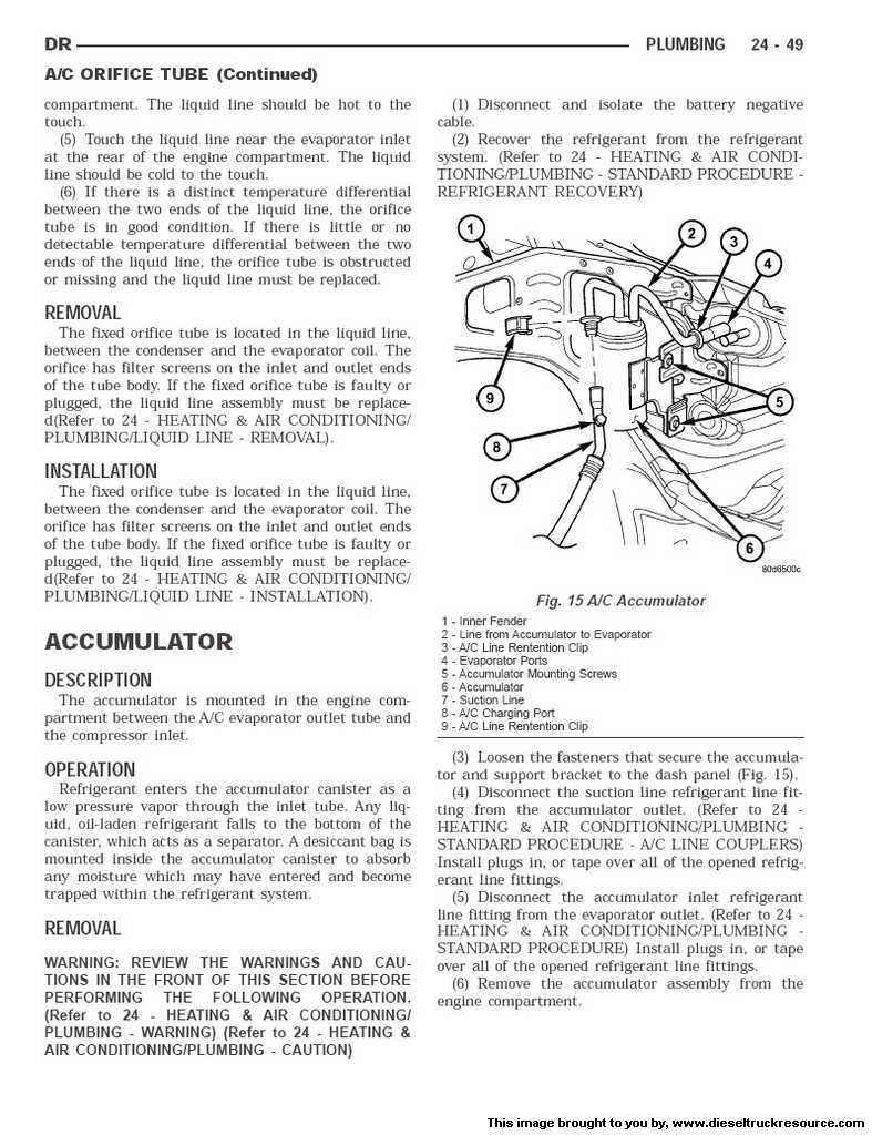

I'm now into my third summer with A/C problems on my '03. Currently, my A/C compressor clutch does not automatically cycle on and off. I am consistently low on R134a charge about every 14 months, so I know that I must have a leak somewhere and a 30 minute vacuum test is now in order. The last two times I have had the system recharged, the evaporator will freeze over after an hour or so of driving. I have not had the fin temp sensor relocation done, so that will be next on the list after the system leak test.
Right now, after running the A/C for about 20 minutes, I get quite a bit of water condensing on the outside of the accumulator (#6 on the diagram). There is also condensation developing on the line (#2 on the diagram) coming out to the accumulator from the evaporator. The condensation from this line gathers on the retention clip (#3 on the diagram). The water from these two locations then drips off and flows down the inside of the right front wheel well liner.
Does anyone else who has a normally operating A/C system notice this amount of condensation on the accumulator? I would think this condensation is not normal for two reasons: 1) If the accumulator and lines have exterior condensation, then they must be at a surface temperature which allows the ambient air in the engine compartment to cool to 100% humidity and allow the condensation of the water vapor. 2) If the accumulator and lines are indeed cooler then the ambient air temperature, then the evaporator has done a poor job of heat transfer, as the R134a refrigerant is still cool when it leaves the evaporator in the line going to the accumulator.
My only other explanation is that the R134a leak is actually occuring at the line from the evaporator to the accumulator, or at the accumulator itself. The small R134a leak is then cooling the exterior of these parts to cause the significant condensation that is occuring. Any other thoughts?
