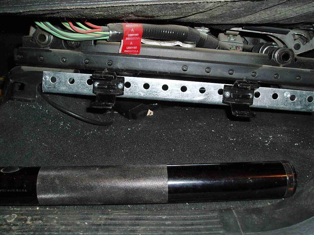

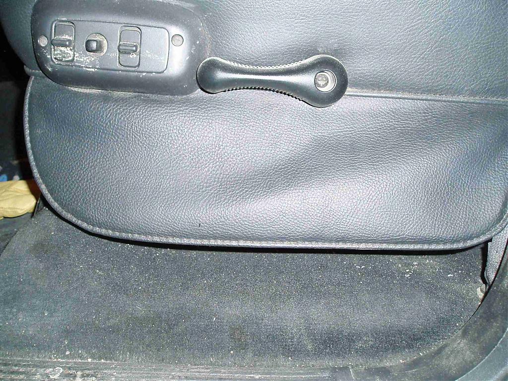

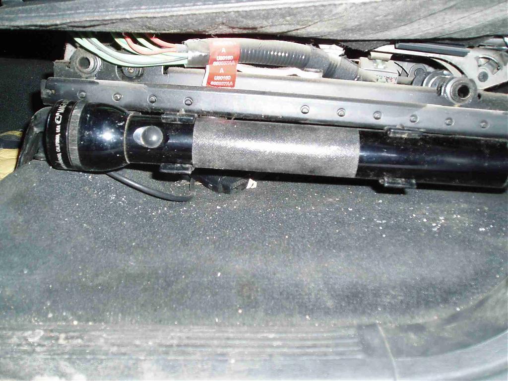

I just put my on, took about 3 min and 5 min to find my stuff to do it. I love tek screws.
Attached Thumbnails Any Pics Of Maglight Flashlight Mounts-flashlight1.jpg   Any Pics Of Maglight Flashlight Mounts-flashlight2.jpg   Any Pics Of Maglight Flashlight Mounts-flashlight3.jpg

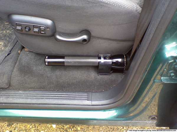

Here's mine, works good for me.....
What did that take to do? I want to mount mine out of sight like that but could not find the correct stuff.
Old Dec 29, 2007 | 02:18 PM
RRAMctd's Avatar
Posts: 227
From: Medicine Hat Alberta
find a piece of flat metal not to think, I used a piece of angle from my overhead doors that was extra. needs to be about 15", screw that with self tapping screws to seat brackets, just below the seat slide. Then space your light clamps on that 4 more screws and your done. Unless you know the light is there you will not see it. tht flap hangs down just like factory. I used #8 screws about an 1" long.
Old Dec 29, 2007 | 03:39 PM
06 DIESEL's Avatar
Posts: 1,473
From: Kingsville, Md
Thanks, where did you get the clamps at? I have everything but the clamps.
Old Dec 29, 2007 | 03:50 PM
RRAMctd's Avatar
Posts: 227
I should have figured that was what you were really asking for as its the key part to get mounted nicely. I had a local parts store order me a set. I have one other set that I got in the kit with the light. I see you can get them here. http://www.shopping.com/xDN-flashlig...brand_mag_lite I did a google search on mag light mounts. never dissapointed with what google can find.
