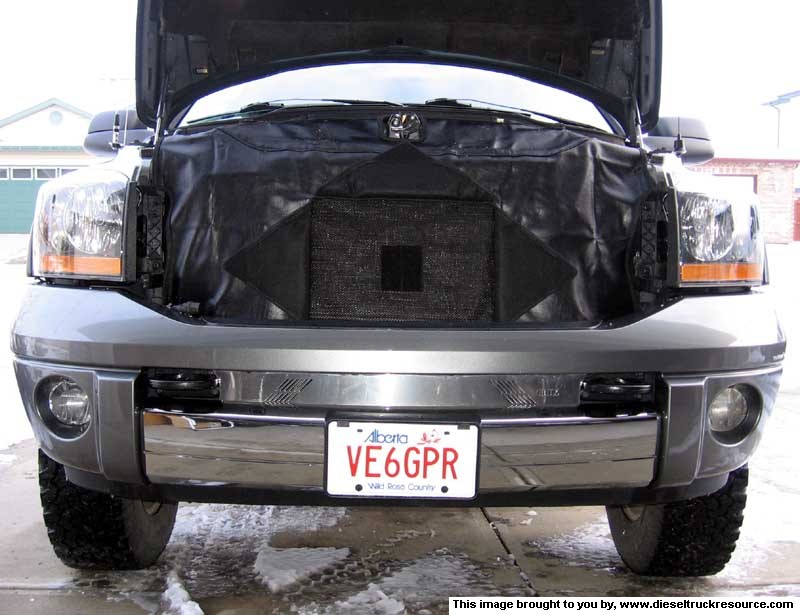

I have a Lund set up painted to match my sport front end, it helps but the mopar unit is way better. It was $160 or so, has flaps that you can open and close as temps dictate, and covers way better than one that blocks off up at the grill.

Mopar has a winter front for these? Behind the grill?

Yeah it's a big blanket that covers everything well.
Here is a pic I poached from B-man, I can take any specific photos you want. I only use my Lund because I like the looks of it.

I also have the mopar front, and it is great. Recommend it to anyone.

cool...thanks for the pic
