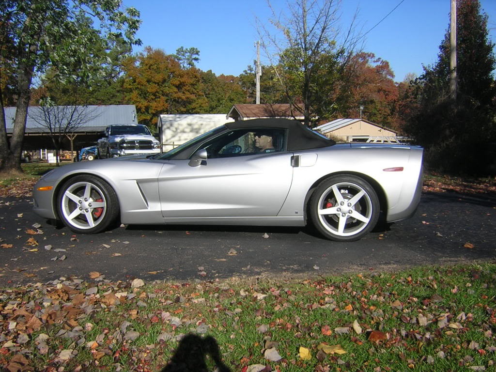

Back just for that one thread. I'm on the Vette forum a lot now. LOL. Part of my bucket list.Name:  newcar002.jpg
Size:  171.7 KB Ac in this will freeze you out! Feels like same volume as in the dually.Just a fraction of the area to cool.

Don't blame ya a bit....LOL

Must be nice... I'm going for the Z06...
