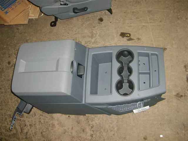

I have an 06 slt qc with the 40/20/40 front seat, I found a center console from a sport model. Will this swap into mine, thanks

It should, may have different brackets, but im doubting it.
Only one way to find out
Check the clearance if you have the floor shifted 4wd, not sure how much room the new console takes up, if it will hit the transfer case console...
Let me know how it goes, maybe ill try to snag one out of an 06 and paint it to match my 05 interior, since no one will ever be ridding in the middle of the front anyway....

Im assuming all the sports have electronic shift for the transfer case? and no shifter on the floor...
The one in the pic above wont clear the floor shifter for the transfer case. Unless maybe you notch it, or they have sport models with floor shift, in that case, should bolt right in. Wont match though, since the bottom of the dash wont mate up with it...

Buddy26,
There should be two more trim pieces that mount to the dash to allow the console to blend into the dash. I see one behind the console, do you have the other?
Also, the console is missing the rubber inserts for the large rear pocket as well as the smaller front pockets.
Does the 40/20/40 center seat move with either of the front seats?
If it does, you will need a different bracket set to mount the new console to the floor.
Let me know if you need any additional info/pics/etc. of the center console.
