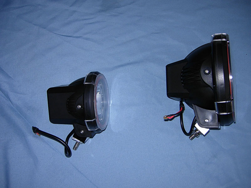

Ok, here are some pics of my install. It was quick and easy and I am very VERY happy with the light output and beam pattern. The only change I am going to make its to re-paint the red aluminum trim ring black...
Enjoy,
-Mark

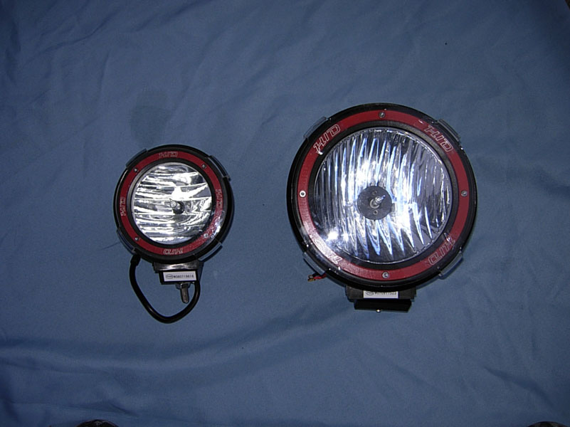

The HID lights I used are made by "Custom Accessories"
I bought 4" to use as fog lights and 7" for off-road lights (photos of that install coming soon)

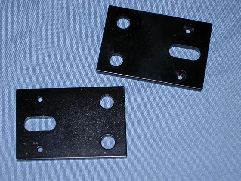

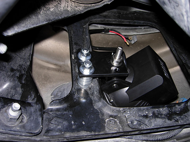

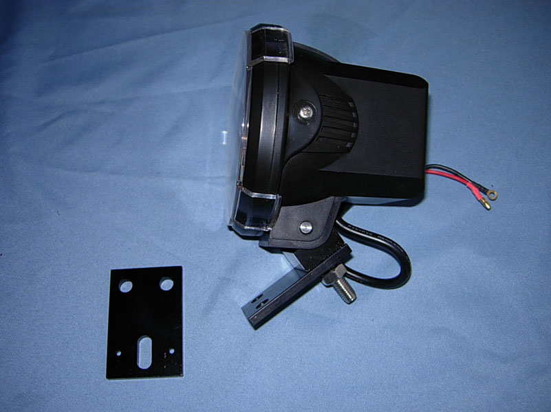

I machined this little bracket to mount the light in the stock mounting location.
I also had to rotate the reflector 90° inside its plastic housing.

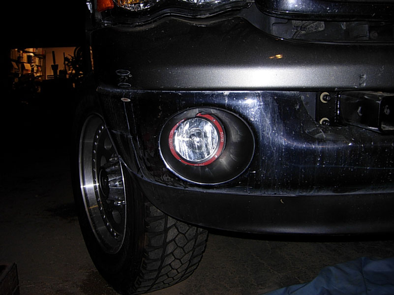

This is how the light fits in the stock fog light location.
I used a stack of washers to get the mounting height dialed in,
then I machined solid stand-offs to replace the washers.
The two small holes in my steel bracket were used to match-drill
holes for 6-32 flat head screws that thread into the aluminum mount
on the foglight. This will prevent the light from ever rotating on the bracket.
The overall fit of the light is excellent, but that red trim-ring has got to go!

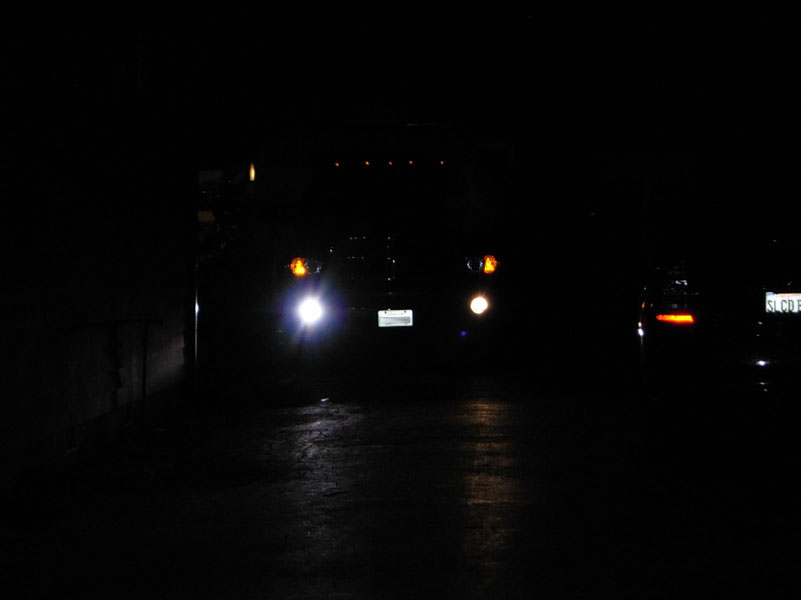

I think that night shots of headlights are completely lame because digital photos don't represent relative brightness very well...
Anyway, here's one taken with the camera-flash turned off.
New HID on the left, stock foglight (9005 bulb) on the right.
Here's another pic' but this time with the camera-flash on.
