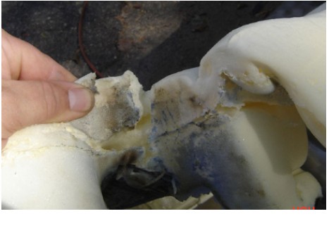

One more continuing issue is with my driver's seat on the 2005 Ram 2500 4X4. This seat is by far the worst seat I have ever had in a vehicle. The seat cusion crumbles away leaving a daily mess under the seat. And once again, I have the frame rails of the seat pushing right up into my butt making more than 15 to 20 minutes behind the wheel pretty uncomfortable. And the manual lumbar has stopped functioning again (2nd time). This seat has been taken apart and rebuilt 3 times. New foam 3 times, and new seat cover 3 times. Back cover twice. 82K miles and it needs it again. Dealer says they aren't fixing it again. Opening a complaint with Chrysler.

I found on another forum a guy who had similar problems. He bought a new foam cushion and reinforced it with spray adhesive and burlap. Then added some additional foam to top sides of seat base.
In the 1st pic, you can see the metal rail that runs from top right of pic to lower left. You can see how sharp part of that is. That is cutting thru foam leaving you with sitting on that bar just under your seat cover.
I performed the repair to my seats in a similar fashion. I only removed the covers in order to install additional memory foam for extra comfort during long trips. Upon removal of the covers, I got lucky and found that the cushions were in great shape, showing no damage.
At the time, I also figured that the metal rail as you mention in the first photograph may be a contributor to the seat related issues for many dissatisfied third gen owners. In order to avoid future discomfort and seat damages, I made a few additional improvements to the seat rails. I used a body hammer and tapped across the entire metal seam on the metal rails. This was done in order to flatten the sharp edges (where the welds are shown) as well as the sharp corner in the rear. At that point, I taped a sheet of Bear Bond (NASCAR body tape)over the metal rail. As an alternative, wide duct tape will work as well. I then applied two strips of rubber underlayment on top of the metal rails, making sure to overlap the sharp corner at the rear. I then applied Bear Bond over the rubber and adhered it to the sides of the rail. Finally, I cut and added memory foam to the center section and side bolsters of the original seat cushions and secured a strip of foam to each of the metal rails prior to reinstallation of the cushions and seat covers. I am very pleased with the results.
