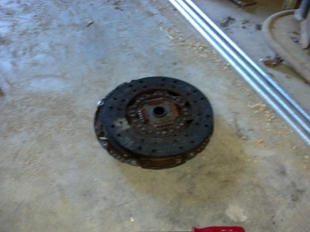

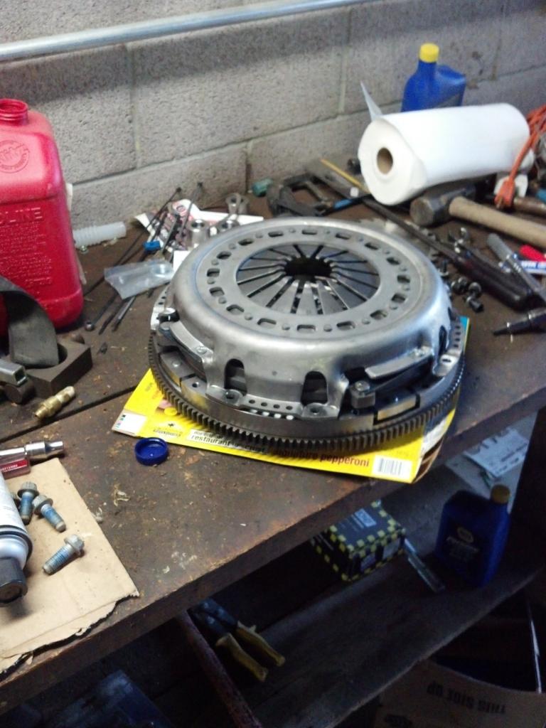

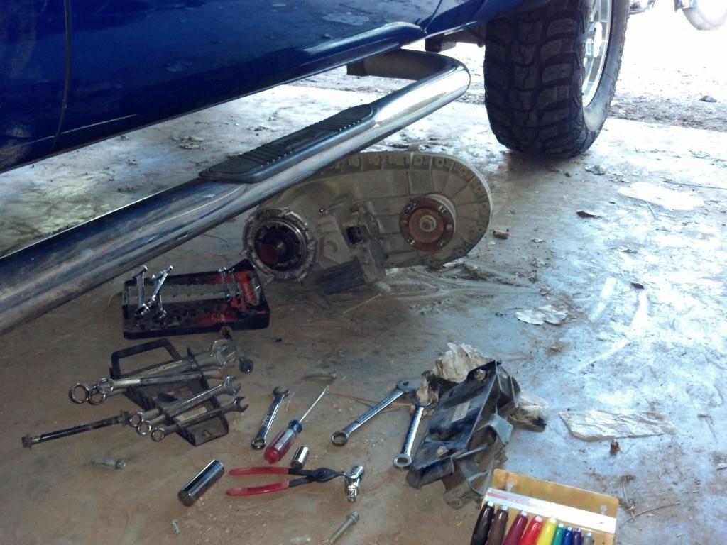

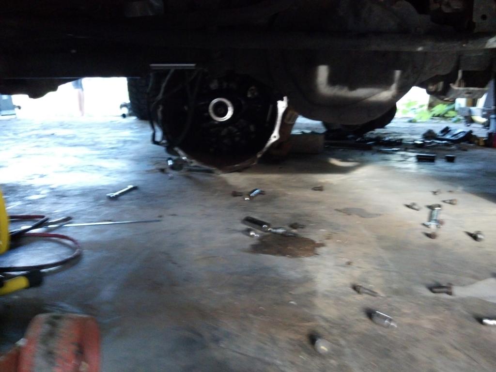

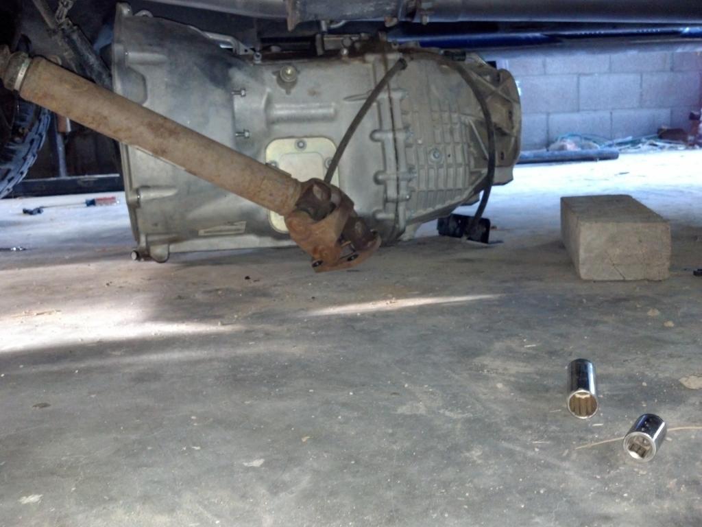

Well guys, the clutch is in and the gauges installed. I didn't take many pics like I planned as my hands were full with the work, but I got a couple.

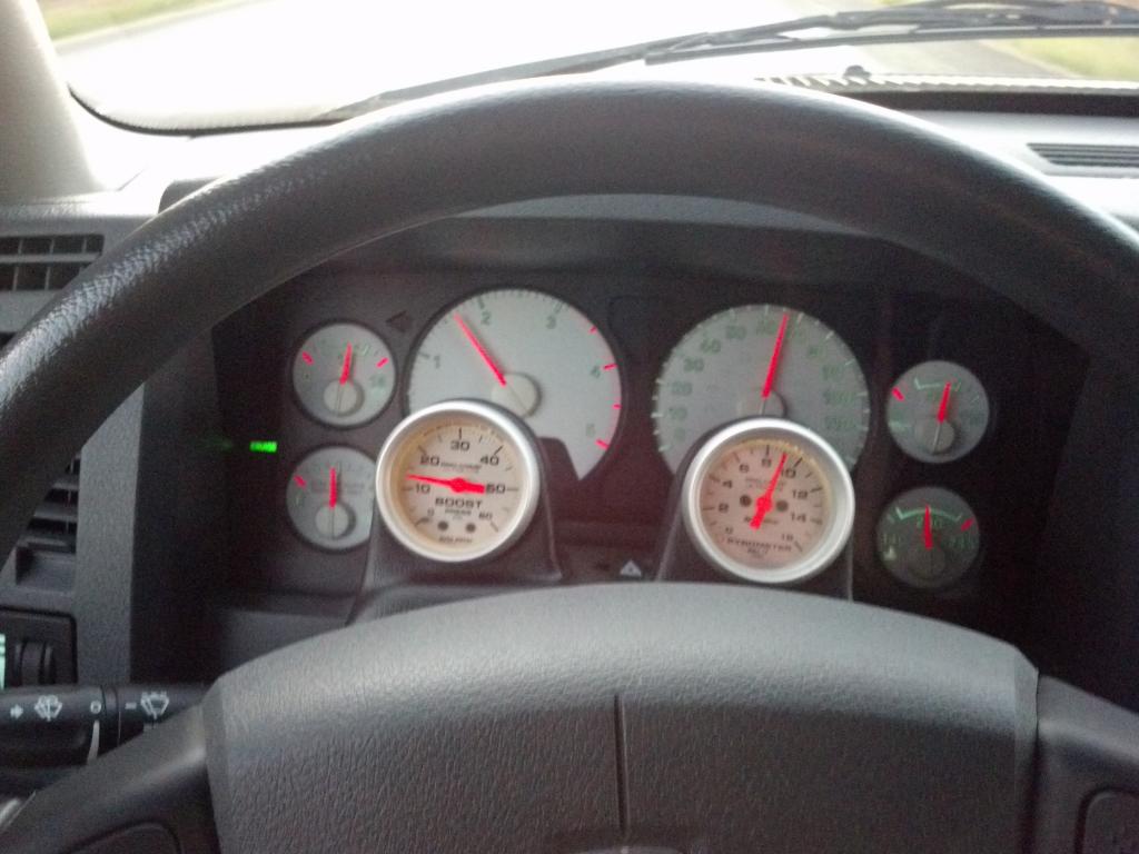

The gauges were easy, ran the wires thru the spot Blake suggested. Tapped into the dimmer switch wire for power to the gauge lights, power for the pyro came from the cig lighter. Mounted them on the steering column in a pod made by auto meter.
As for the clutch, Oh boy. Not an easy chore for 2 guys to do on the shop floor. My advice.... if you're not gonna pay someone else to do it, get a tranny jack!!!!! We tried doing it with a floor jack and ended up renting a tranny jack. Wasted a whole evening fighting it on a floor jack trying to get it stabbed back in. And while it's out, do the rear main seal as totally suggested. I also changed out the gear oil. Easy to drain before you drop the trans, then refill it from inside the truck before you put the shift tower back on. Anyway, here's a couple pics.
I kow this is kinda vague, I did all the work a little over a week ago, so I'm a touch fuzzy on deets. I'm sure if you ask something I'll remember though...

And here's the gauges installed
Here's a pic I took of the gauges. Look at them closely and you can see she's not working very hard. I was pulling my brand new KZ spree 32ft 8000# camp trailer when I took it. Also just a pic to show off my GDP manifold...
