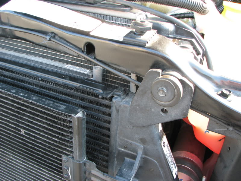

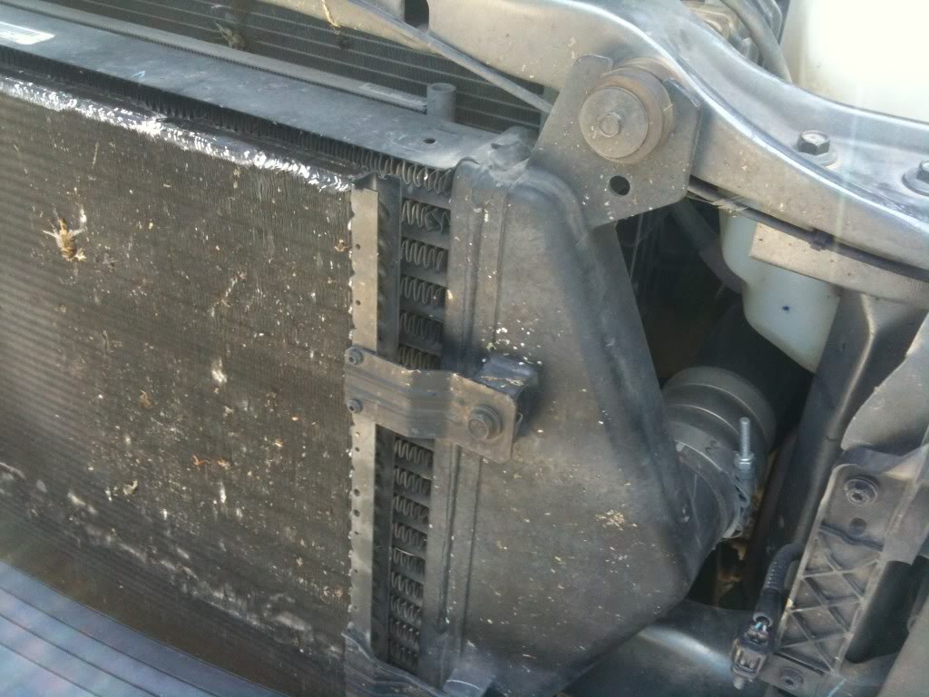

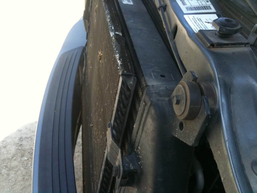

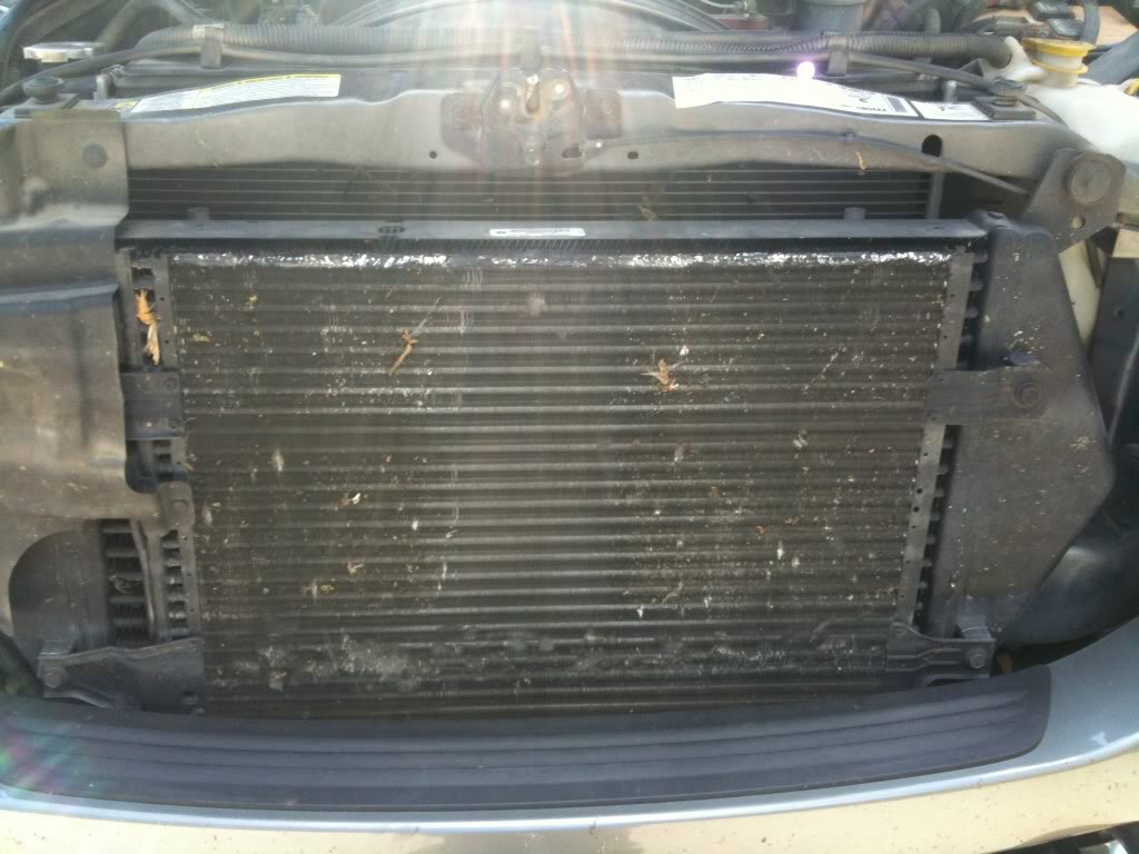

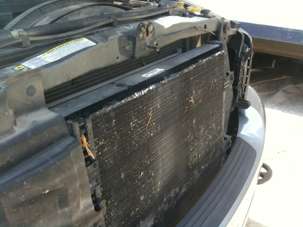

Ok,
It has been raised as to when the 6.7 got the smaller intercooler. I personally am not sure, so I figured we could have a thread with pics and try to narrow it down.
Here is mine, build date of July 2007.

Ignore the bugs.

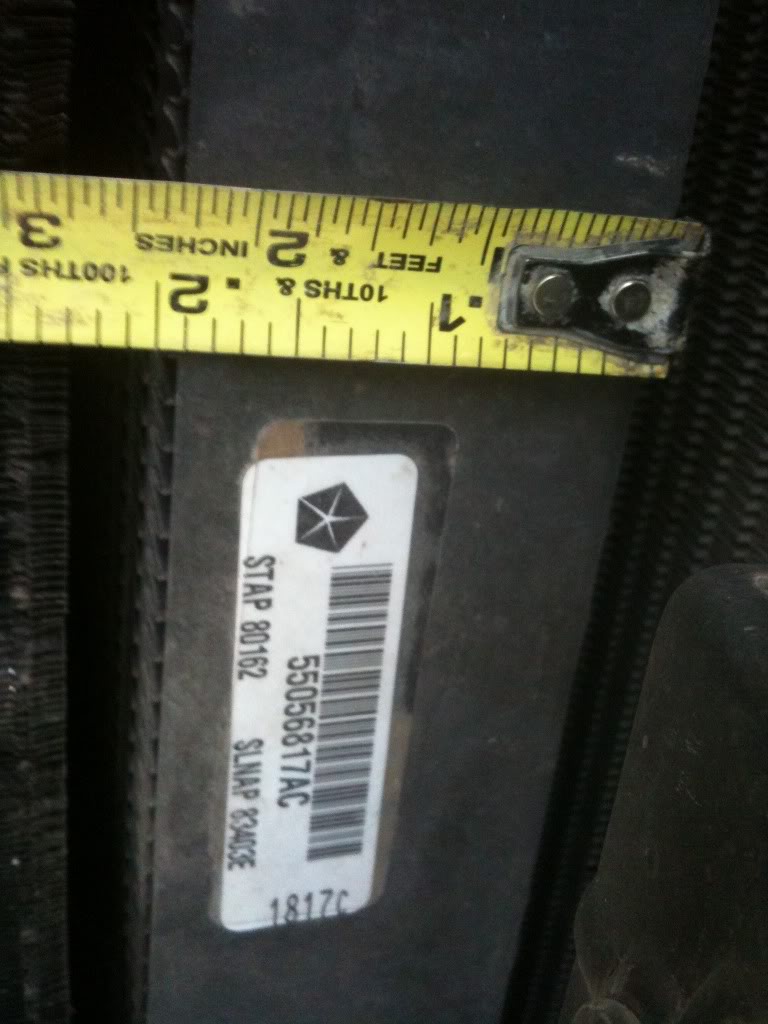

I added in a pic that shows the measurement of the cooler and the part number.

The larger intercooler is the same part # for 2006 through 2009 - Part # 5170704AJ
The smaller intercooler is part # 55057092AA and it is listed in the 2008 through 2010 catalogs. (for 2010 only for cab & chassis & 4500/5500 - not the new body style)
I just checked mine and it is the larger one - the tag # on top is 55056817AC but it is not a good part #.

Blake, you guys have some big bugs down there. At first I thought that was a bird stuck on the a/c condensor.
