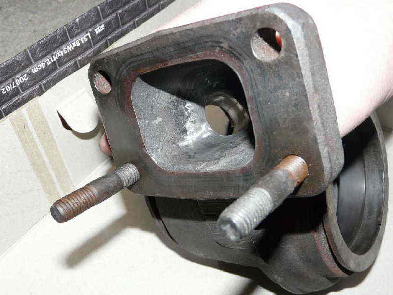

You are exactly right, you need to open the stock turbo's wastegate sooner. This will bypass hot exhaust gasses around the stock turbo's turbine wheel and give the S400 faster hotter exhaust so it performs a greater share of the air compressing.
If you plan on big 600+hp and you have a few hours on a Saturday, take the stock turbo off and port out the wastegate passage. It measures 19mm and can be ported to 26-27mm and still have an adequate seal with the puck/flapper. Increasing the port size will create more surface area for the exhaust pressure to work on. Increased surface area will let the puck open with less total drive pressure; this along with a larger port will bypass more exhaust flow all else being equal.
If you can find a lighter spring, that would definitely help drive the S400 harder and lighten up the load of the stock turbo.
