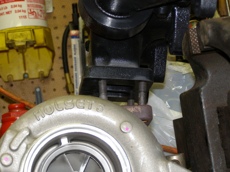

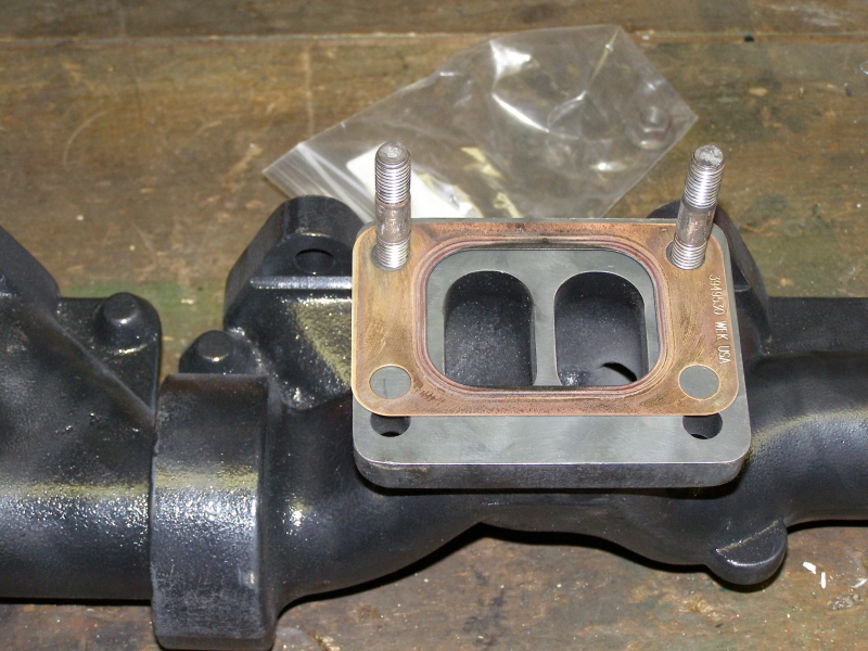

I have a weird question for anyone running the ATS manifold? I ordered the II sps6280 super phat shaft turbo. Also at the same time ordered the manifold. Brandon at II said it should work. Well get them wed. Go to install them over the weekend and the flanges dont line up!! I kinda checked them on weds nite to make sure just for that reason. The studs line up side to side but not front to back. I did some research on it sun and the number i got was the same and right but to big. The turbo bolted right to the factory flange no problem. SO has this happened to anyone before? Brandon was going to look into it for me after i sent some pics to him today. But no response yet. Any input would be great. Thanks[IMG]turbo flange[/IMG]

this may be a dumb question but I have to ask...did they just send you the wrong gasket??
or have you tried the turbo too??

Yeah tried the turbo to. NOPE not the wrong gasket. That was the factory one.

There you can see the turbo to the manifold. Even though that is the stocker. The stocker and the sps have the same turbo flange.

did they send you a 12v ATS manifold???

It doesn't look like it is going to fit. I would give them a call and I am sure they will get you up and going soon.

I did just that a few min ago and yeah they are goin to set me up with the right one. As far as the 12v goes don't know for sure. Brandon just said it was wrong and for me to send it back and he would credit me for the return and then send the right one. But now the time of just waiting is killing me. I just hope I get this done by the next 2 weeks or so. I got to go to new york to pick up a 21ft baja boat for my buddy.

You have the wrong manifold. It could be a T-6 flange?

That was possible. But not to worry anymore because its in the mail as I type. Thanks for all the info!!
