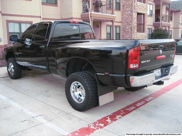

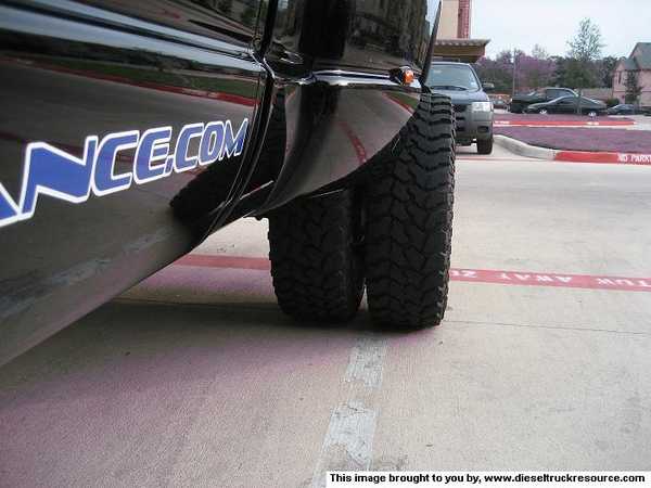

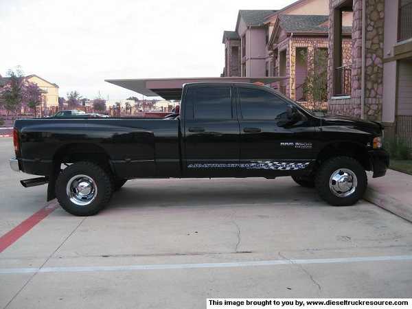

These are 285/70/17s with 1.5" spacers in between and 1/4" spacer on the very inside....

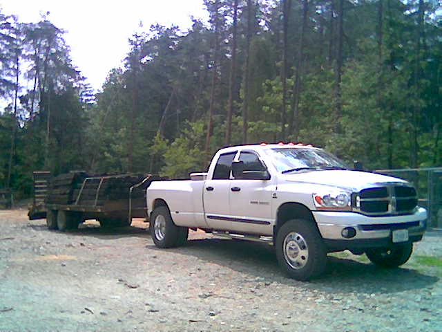

I will get you a picture but the 19.5 does not stick out the fender at the top!
on Edit:
the trailor weight in this picture is around 19k.LB.

Armstrong Performance, did you have to put the 1/4" spacer on the inside because they were rubbing, and do you have enough space inbetween the duals when you tow?

With the 1.5" spacers, about a 1/8" of the trucks studs stuck out past the spacers, so I had to put them on the inside. I have PLENTY of room while towing.
