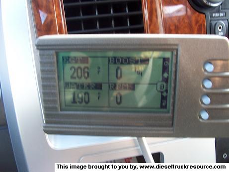

what was said above about guages , and quadzilla makes a 65hp tow box thats called XZT, it mild enough u wont have to wory about your tranny and will give u more power and better fuel milage if u keep your foot out of it. these are the guages i have, girst is auto meter ultralites and second is the comander by quadzilla
