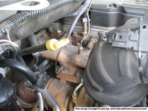

A Type K thermocouple - such as used with a digital pyrometer (not sure what the Recon uses) - is usually quite reliable and exhibits very little creep as time passes.
For NIST standards, annual calibration is required, but otherwise, if the 'couple is accurate within a few degrees of freezing, ambient or boiling - it'll be fine for the higher EGT range... unless you REALLY need to know if it's 1245*F or 1260*F
When using multiple non-identical probes, their construction as well as placement and installation will affect their "accuracy" far more than any calibration issues!

two probes
so is this a good location for the probe
