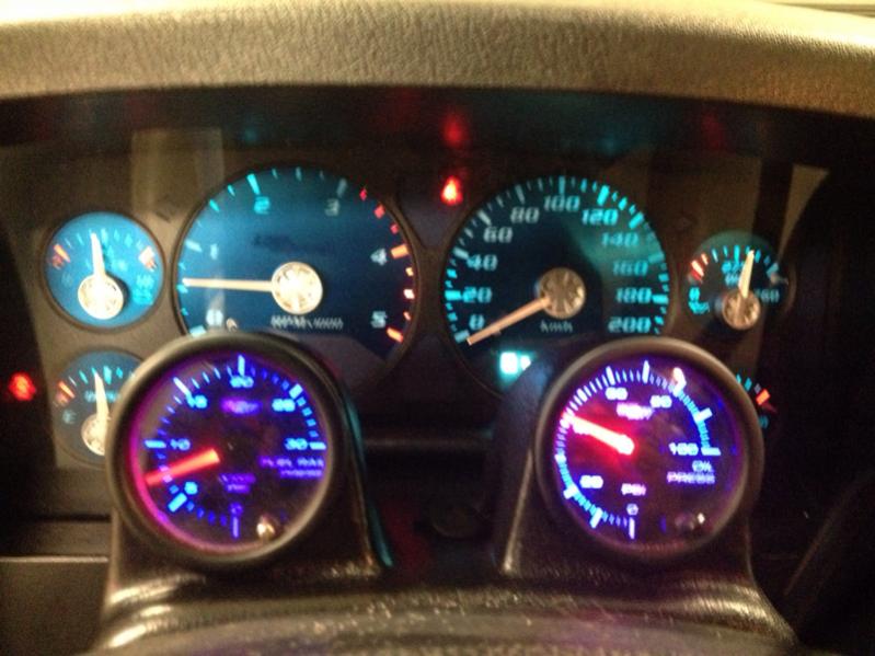

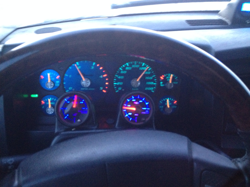

Alright... Finally installed! I really like the new look...
Attached Thumbnails Tach Issue - thoughts-image-300088450.jpg   Tach Issue - thoughts-image-345586166.jpg

I like it!!!!
