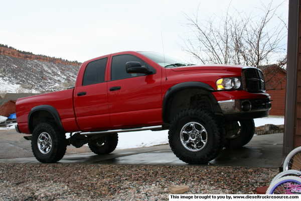

Not a great picture of mine, but all I had available. I have the "regular" 6" Superlift kit. I did go with the Bilstein 5100's all the way around and the Bilstein dual stabilzer. I had some tire wear issues and later developed DW. I added the double front shock hoops with more Bilsteins up front. It made a big difference. The front end feels better planted on rough roads. I also added the Thuren track bar when I bought new rubber. I couldn't be happer with the ride.
