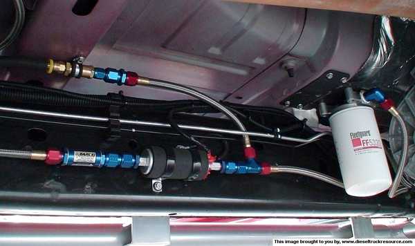

12 psi? WOW! That's all? I know it's more of a volume thing than a pressure thing...
Where do you take your reading at? I've seen your set up, it's nice.
Triton's set up...
Triton's set up...

I read my FP where the adapter from the stock LP bolts onto the ff canister.
Hey, Ty, where did you get that setup? I like the SS braided line. How far does that run? Just to the filter, or all the way?
