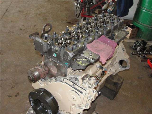

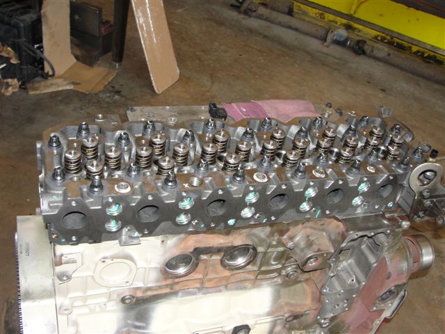

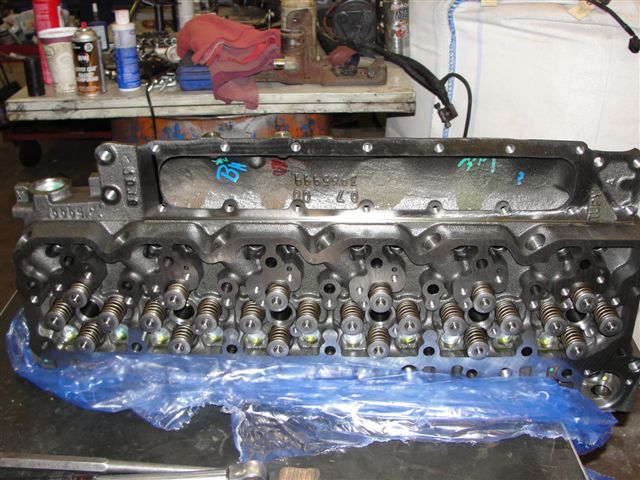

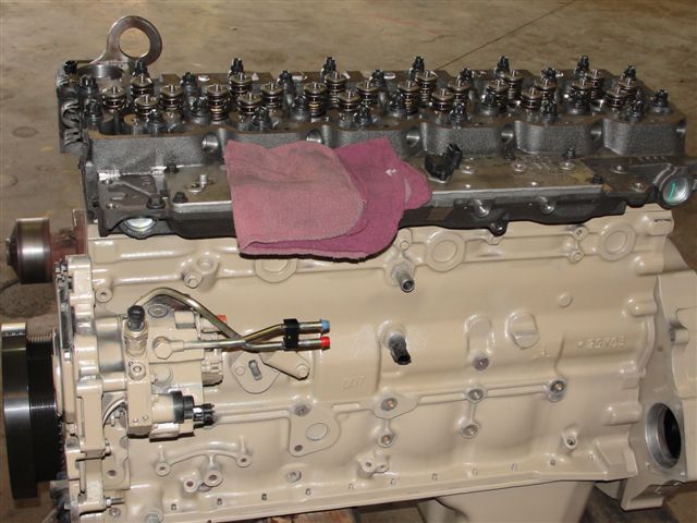

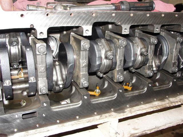

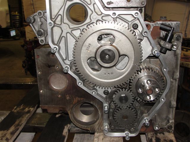

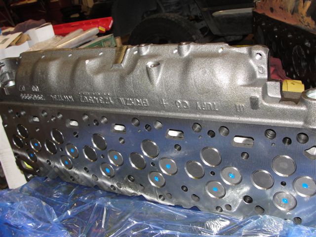

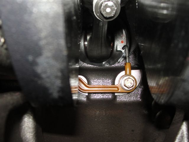

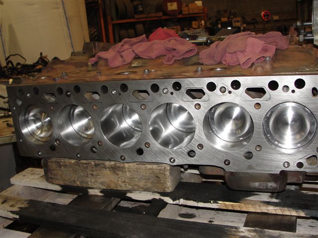

Hey guys,
Thought I'd post some pics.
Attached Thumbnails rebuilding my 5.9-5.9-going-back-together-001.jpg   rebuilding my 5.9-5.9-going-back-together-003.jpg   rebuilding my 5.9-5.9-going-back-together-004.jpg   rebuilding my 5.9-5.9-going-back-together-005.jpg   rebuilding my 5.9-5.9-going-back-together-006.jpg

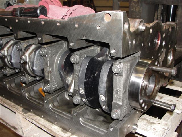

Old Mar 9, 2010 | 03:57 AM
Topper's Avatar
Posts: 1,121
From: Glen N.Y.
1 more
Old Mar 9, 2010 | 04:14 AM
COUNTRYBOY's Avatar
Posts: 895
From: Silver City, NM
Looks sweet Topper....

that looks nice. i remember when i had mine out. you will be happy to get it back in and running down the road. can't wait to see how it turns out.

Old Mar 9, 2010 | 07:31 PM
1985cucv's Avatar
Joined: Apr 2008
Posts: 1,960
From: wisconsin
how do they screw the freeze plugs in the head

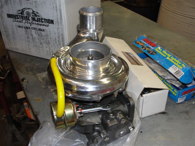

Hey guys,
Here's a few more. New pistons (40 over) new cam and lifters- (Hamilton big stick) new head (stock from Cummins) new 110 lb valve springs & push rods (Hamilton). Arp head studs (625's) fluid dampener. Also a new II silver 64 turbo.
Of course all new bearings and gaskets top and bottom.
I have around $7,500 into everything. I think if you check that is a real bargin... The only thing I wasn't happy about was I had to pay a little over $350 for the 40 over head gasket.
Can't wait to get it back into my daully!

Looks like its coming right along, I'm sure you will be happy with the decision to go with .40 over as it will make a great daily driver and still very streetable!
