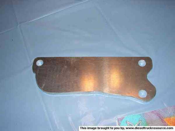

[IMG][/IMG]
there is my roughed out plate. i need to check it for fit, then smooth it out and template it for you guys. yes it is upside down. sorry.

Originally Posted by dodgezilla04
[IMG][/IMG]
ZILLA04
Looks like a nice piece!!!!!!!!!!!!!!!!!!!!!!!!!!! Can't wait to here how it works out and installs!!!!

dodgezilla04's Avatar
Joined: Jun 2004
Posts: 0
From: kingston,wa
thanks, you're easy to impress. it feels like a hack job to me, but once i ensure the fit, i'll fix the finish.

got the plug and plate installed today. took 10 minutes. layed over the valve cover to install the passenger side bolt. reached in through the drivers wheel well to install those 2. just alternately tightened them until the plate was flush with the block.
then did the tstat mod. clipped 1 barbell. time was less than 5 minutes.
drained the little coolant that was left. refilled with extended life, distilled water, and one 15 oz bottle of diesel water wetter. and went for a gentle drive to purge air and check for leaks.
with the tstat vented, it does take longer to get to temp, but it does reach the same spot on the gauge it did before. i am happy, and back on the road.
i made a template of the plate. you guys want me to mail you a photocopy, then shoot me a pm with a mailing address.

so does ypur plate rest/seat against the freeze plug it's self???
the ones on TDR have the aluminum plug piece hooked to the block off plate and that holds the plug in place????
