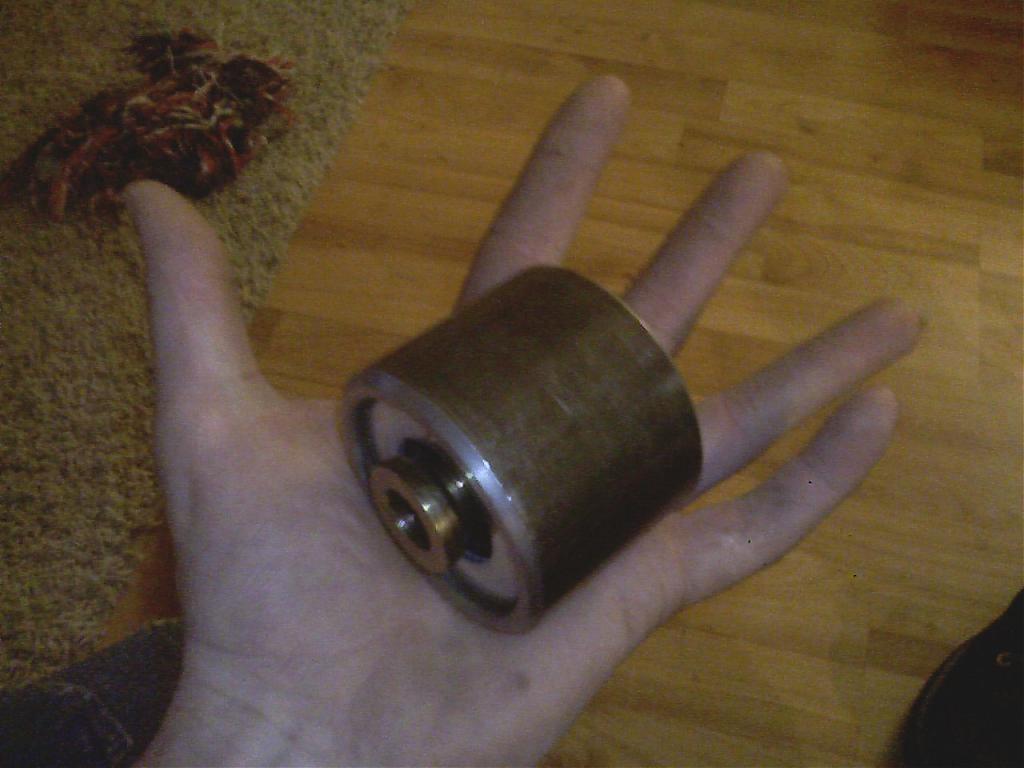

do you have one jamb nut or two on each heim joint? ive built a ton of minitrucks and used heims, problem is they get sloppy after awhile and especially with the torq of cummins you dont wana run heims, i put the rebuildable super joints on my front long arm, and on my rear traction bars im running bushing, chevy bushing will slip right into 1 3/4 tubing and are only 80 bucks for a whole set, also when the heims start wearing out they will clunck at every acceleration shift. and i really do recommend traction bars on the rear of the dodges especially with a 6spd.

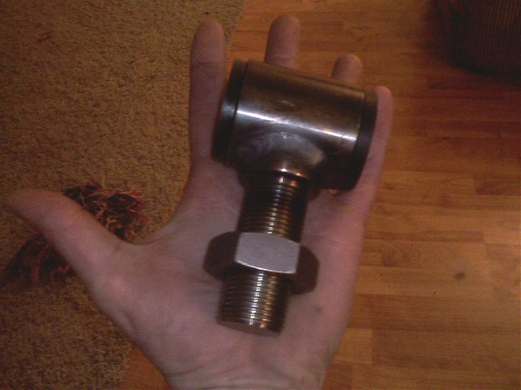

trik, they loosen cuz some companys or people that make there own dont really have a clue on RIGHT and LEFT hand threads, so they put two RIGHT hand threaded heims on one bar and they do loosen up with the force back and forth of driving.
i use these super joints that are rebuildable and fit right in place on the front axle, i used the pollys with 1 1/8" stud for adjustment on the long arm and my traction bars.Question About Traction Bars-1201072119.jpg
