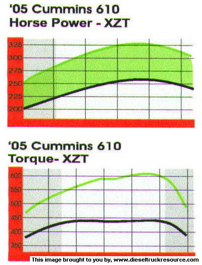

Here are some examples of dyno results on the new Xillaraider boxes, which can be found on sale this month in the DTR Online Performance shop Here
You can see a larger, clearer view of these in my photo gallery.

Thanks Larry and Onesource. I'm pretty sure I'm going to order the 140hp version for my '03 235hp Cali truck. That should wake it up. Looking forward to seeing your numbers.
