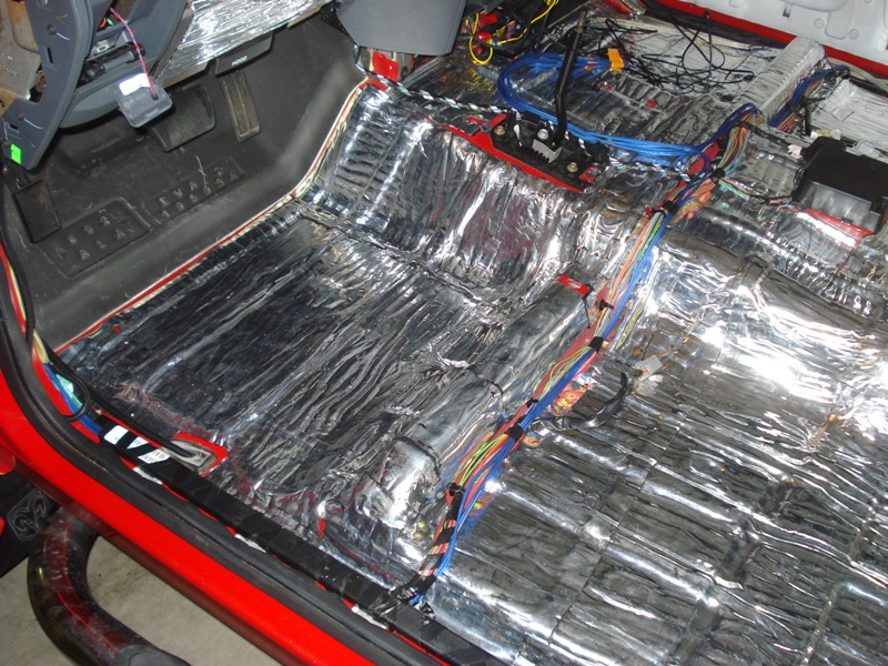

How much fun was it Dynmat'ing your whole interior? How difficult is removing everything to Dynamat it?

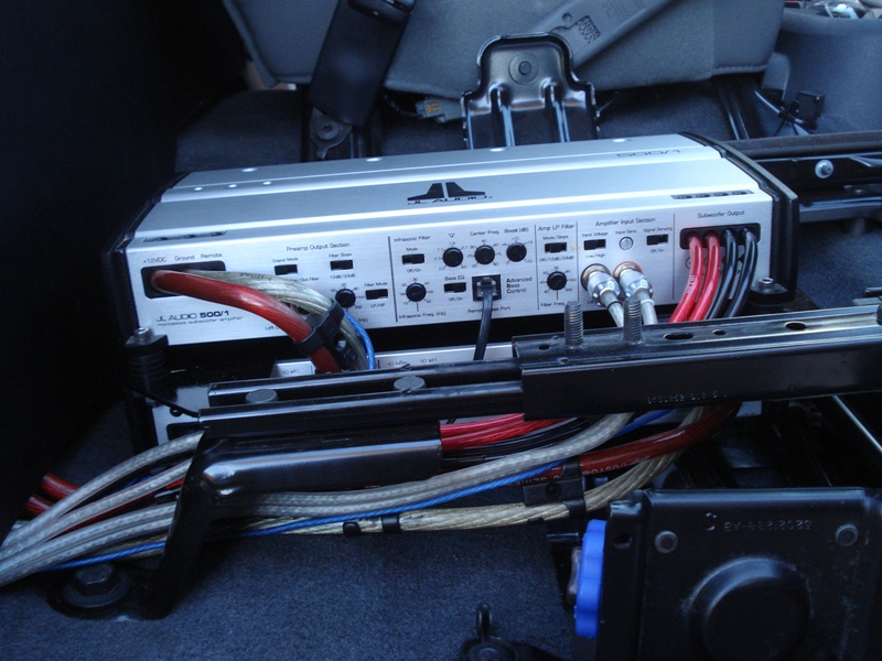

Love the way your subs/amps are mounted. That safe is a great idea too. Do you have the boxes mounted the floor of the truck? How did you attach them?
A lot of work! Not really hard though, just time consuming.
Yes, the box is screwed into the floor from the sides with brackets and inside.

Did you use the Metra, or American International install kit, and why? N/M, I see now you used Metra.
Great looking install though. How did you run your power and signal wires? Through the cab, or, poke it up from underneath?
Power is run through a gromet in the firewall and down one side of the truck on the floor under the carpet. RCAs are run down one side in the headliner.
