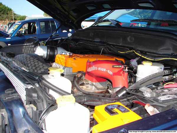

The paint I used was not made for plastic or anything, but it was a "heat resistant" paint. Just scuffed, primed, and painted and it still looks as good as the day I shot it. Been on almost a year now.
Old Nov 28, 2006 | 01:57 PM
Nate-03 D's Avatar
Posts: 1,303
From: Minnesota
^^ That looks realy sharp. I like that glossy look alot.
