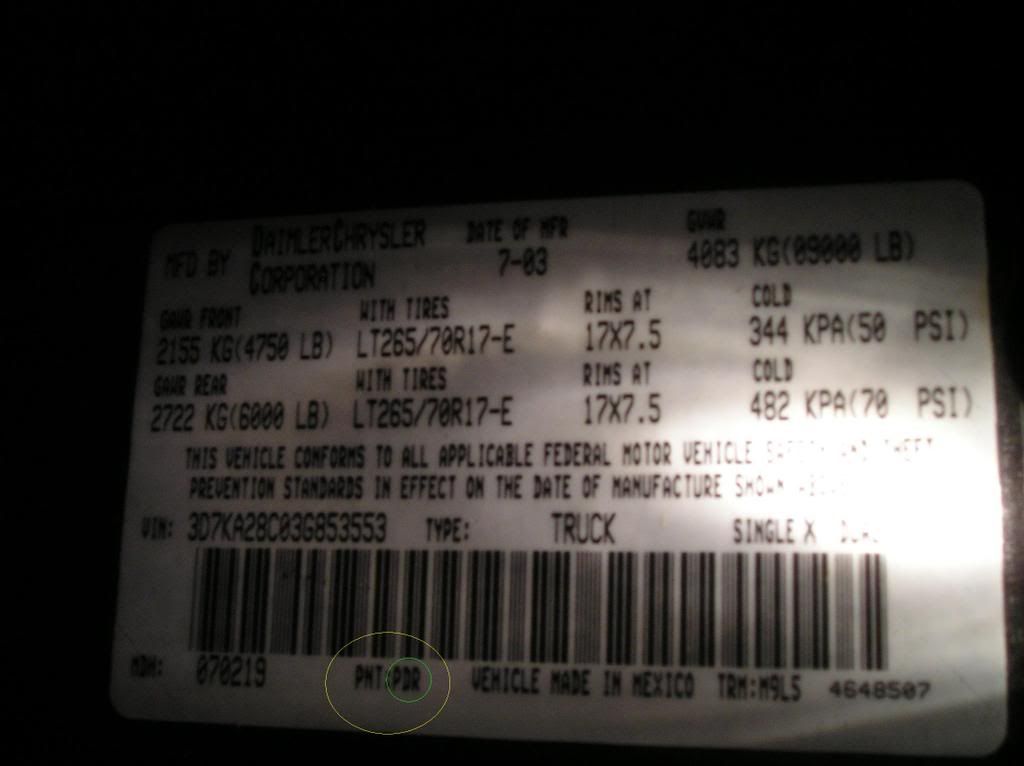

First thing, you’ll need your paint code which you can find on the drivers door panel.
My code is PDR, the 2nd tone wasn’t on mine so I had to work to get that one. Here’s a link with Chryslers color charts.
