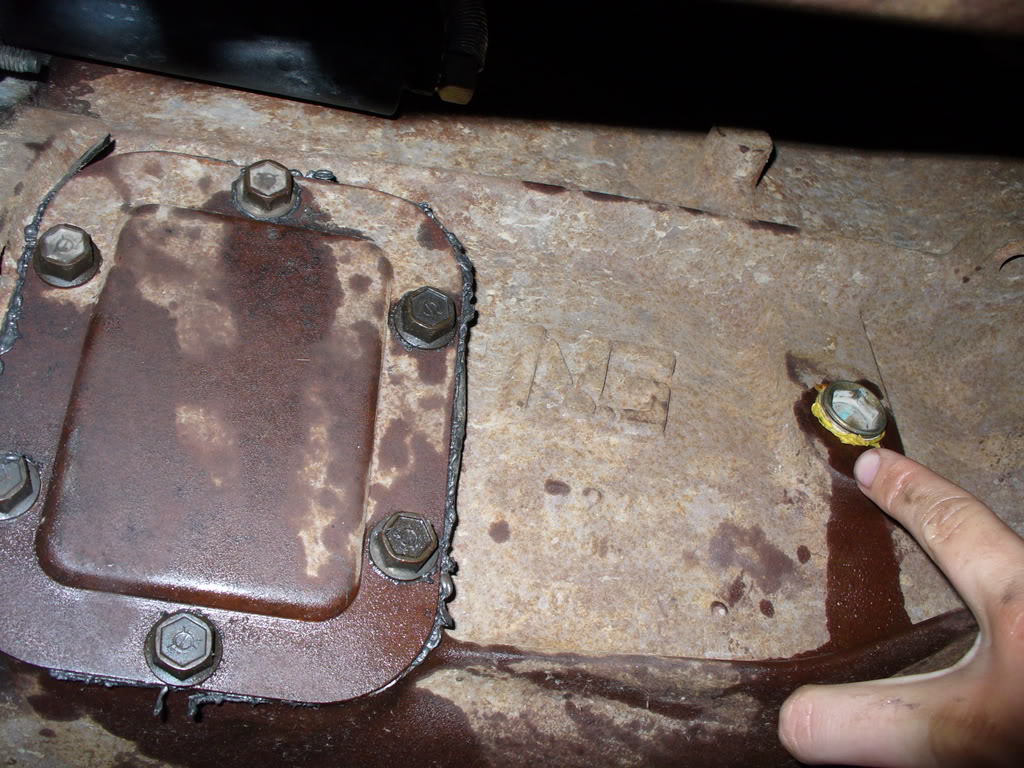

T case drain plug. use 10mm allen. Make sure you can get the fill plug off 1st.

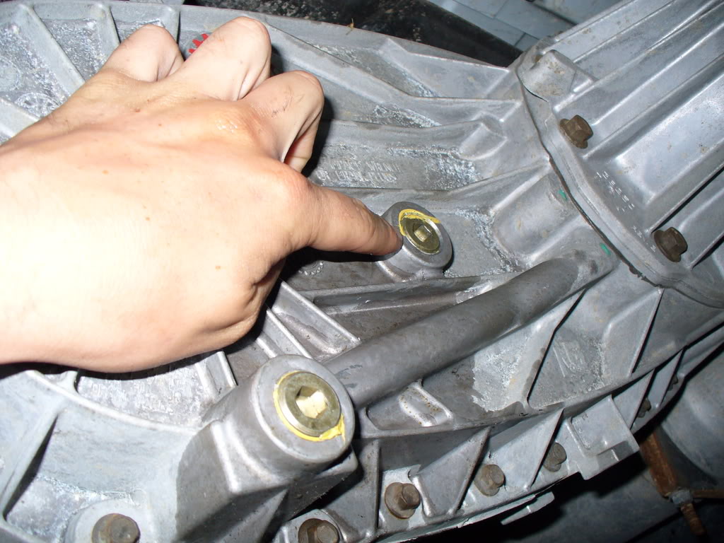

tranny fill plug

tranny drain bolt

tranny drain plug all on drivers side. We took a screw driver and hammer to get the cover off Oh so Gently and a 14mm wrench for the pto bolts. 17mm for the tranny fill plug. Put ultru black silicone back on the pto cover. Use teflon on the drain and fill plugs.
