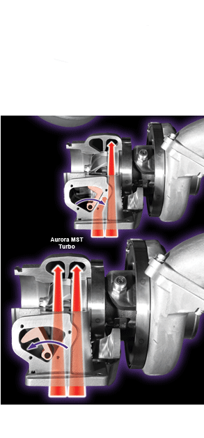

Yeah, it stands for Multi Stage Turbo. Supposed to give you the fast boost and acceleration of a smaller turbo + the ability to build the large boost of a large turbo. It has a valve that opens and closes to diff. chambers depending on boost pressure. It sounds like an awesome setup but they have been talking about it for a few yrs now it seems. They continually say "Coming Soon....",. I would love to see how the thing works and hope it does arrive soon, but I won't start holding my breath.
Anyhow, here is a link the page that has the best pics and discription of it I've seen.
http://www.atsdiesel.com/ATSWebsite/catalog_01.asp page 47 BTW

From what I've read the MST isn't like the 6.0's and the Dmax VGT turbos.
The MST from what I gather only has two positions, a big exhaust housing and a small exhaust housing. It starts out by closing off one of the volutes of the turbine housing forcing all the exhaust to flow through the other volute at low boost. A valve opens at some point and allows exhaust gases to flow through both volutes.
I do remember that someone around here has the MST on top of an A5000 in a twins setup.
