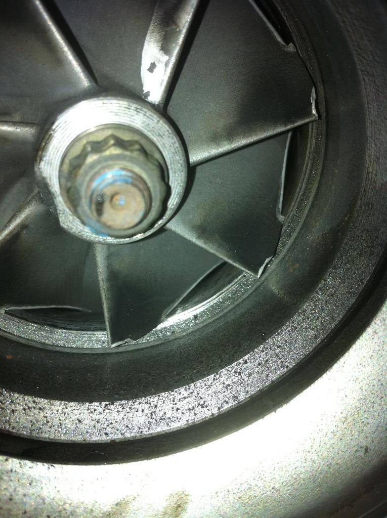

my turbo is making a funny noise........pics
i cant belive that it held as long as it did getting it home driving up the steep grades. it had about a half inch play in the shaft and scared the crap out of me when it let go.
what to do next.......

Thats stinks! Well whatever you do dont run anymore than you absolutely have to. Sounds like you need to start looking for a replacement. Check you boots to see if you have any shrapnel tears. Might wanna pull the intake horn off the see if any pieces made it into the grid heater. Maybe shop vac out the intercooler.

Most likely from running it for 3 months over due oil change, kept driving it hard when it first started making a slight squeeling noise and an air filter that should have been changed 50k ago. paying for it now ...

Did the shaft break or was it just bearing failure? Last one I saw that looked that bad the exhaust wheel broke off.

just the bearing .... at first i was just hopeing i had a hose blow off ....but the bearing finaly had enough....

ummm, where did the shrapnel go?

as for the pices off the turbo ...im hoping that they were small enough that they stayed in the inercooler ... i do plan on getting a new one
I would be doing more than hoping...

I would at least pull your horn and look and see if there is anything in the manifold.. Or your build budget will quickly get turned into a re-build budget.
At 30+ psi and 700+ CFM little pieces will make it into your pistons.

Chances are as small as those shavings where they already passed through the engine without harm as you drove the truck with the failed turbo. I doubt many of the shavings are left to be found in the intercooler.

i had a little oil in the tube that goes to the cooler but im asumming that was from the bearing going ...
