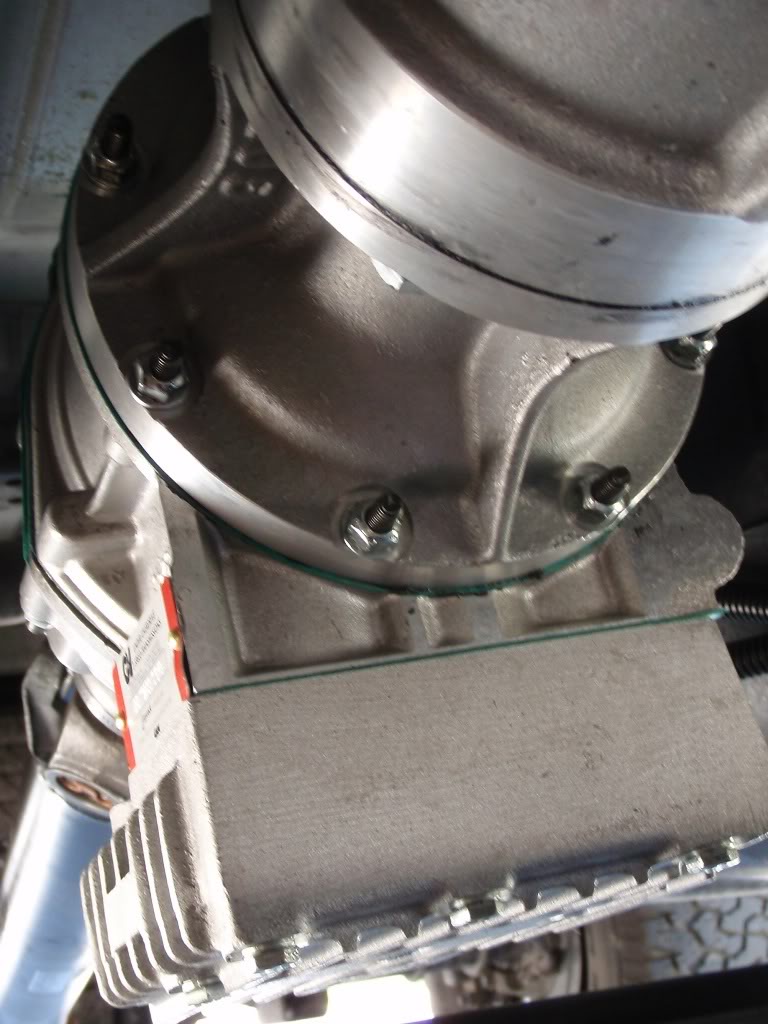

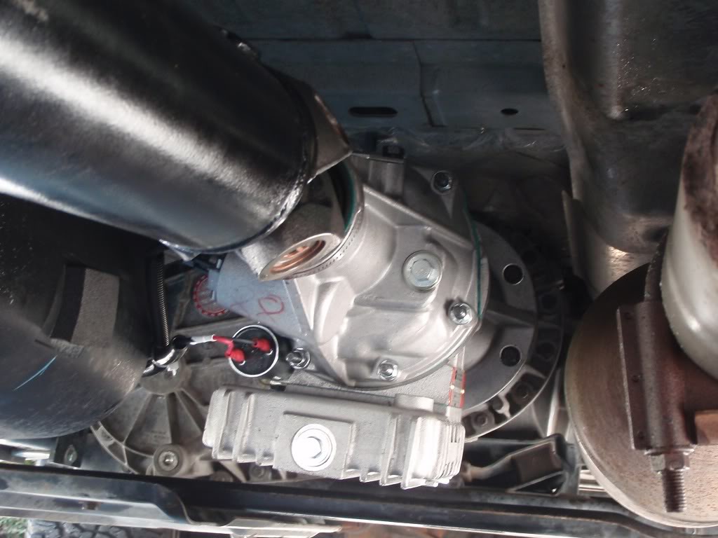

I would like to share with everyone my experience with my latest toy. I bought a Gear Vendors auxiliary overdrive (http://www.gearvendors.com). It is basically a small second transmission bolted behind the transfer case. There is a lot more info on their website about it, but I mainly bought it to lower my highway cruising rpms. Here are some installed pics.
Side view.

Front view.

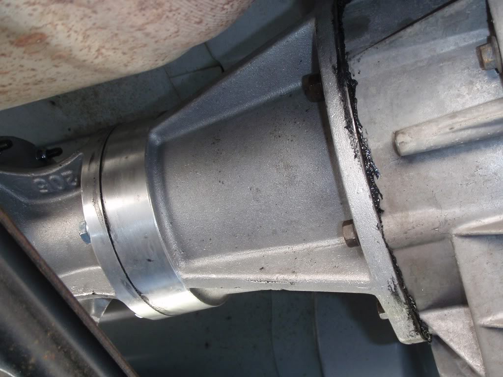

Adapter between unit and transfer case.

Shortened driveshaft.

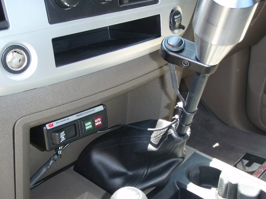

In cab controls.

Master switch.

Shifter-mounted activator switch.

Once the I hit the switch, the red light (auto-drive) lights up to let you know that a shift is commanded, and then it switches to the green light (over-drive) once the unit successfully shifts. This process only takes a second. However, if you are going less than 18mph, then it won't shift and the red light will just stay lit until you get over 18mph. You don't have to hit the clutch to shift, although its pretty rough if you don't.
Right now I think the inside controls look a little tacky, so I will be redoing it soon to hide the wires better. As far as use, 4th over is pretty close to 5th (1.08 vs 1.00) and 5th over is even closer to 6th (.78 vs .79). Because of this, I did a little ratio math, and I've decided the best way to shift for me is 2nd, 3rd, 4th, 4th over, 5th over, 6th over. There is no issue going from one gear to the next leaving the GV engaged (say 4th over to 5th over). Using this pattern gives me the following shift percentages compared to factory:
How I shifted before (G56)
2nd 3.48 > 40% shift > 3rd 2.10 > 34% shift > 4th 1.38 > 28% shift > 5th 1.00 > 21% shift > 6th 0.79
How I shift now (G56 w/ GV)
2nd 3.48 > 40% shift > 3rd 2.10 > 34% shift > 4th 1.38 > 22% shift > 4th over 1.08 > 28% shift > 5th over 0.78 > 21% shift > 6th over 0.62
My RPMs at 70 dropped from 2100 to 1600. In fact, my truck lugs a bit at 1600 so I don't put it in 6th over unless I'm going 75 or more. Once my speed falls below 75, the EGTs start climbing (100-200 degrees). Hopefully when I upgrade my turbo it will take care of the EGTs and I'll have more power at 1600 RPMs so I can cruise there at 65-70 mph.

What kind of fluid does the GV take, and does it need changed often? Any filter internally? How long did the install take and what special parts were needed?

Where did you get the rear drive shaft. And what are the specs on it?
I haven't changed the fluid yet, but the interval is 5k miles. The manual has some kind of oil listed; I am planning on calling Amsoil and ordering their equivalent.
I am unsure about the filter, I need to read through the rest of the manual.
I was lazy and paid an RV depot to install this for me. It took them 6 hours to install.
I got the driveshaft from between my transfer case and my rear differential .
I'm just messing with ya, but seriously, they just shortened my existing driveshaft, I'm not sure exactly how much.
