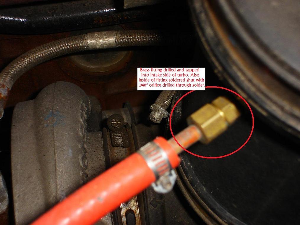

Basically the system has 4 components: 1) Pilot operated hydraulic valve. 2) 12v Air Neway valve (we use them to operated hyd valve systems remotely) 3) Adjustable LP gas pressure valve(found on deep fryers, big camper stoves, etc.) 4) Brass fitting w/.040 orifice(melted solder inside and drilled hole)

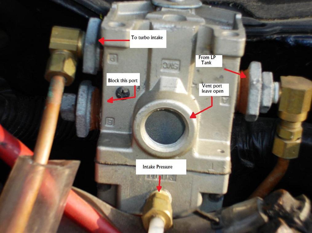

The pilot operated Hydraulic valve I found on EBay, bought a box full of them for $35.00, came to like $8.00 a piece, the one I have is an SMC brand, part# NV8A3135-04N, the pilot is 10-12 psi factory, I had to grind the spring so I had 3-5 psi that is where I wanted the valve to release. A hydraulic valve works well, the moveable steel piston is lubed from the LP gas as the gas will leave an oil film. I don’t quite understand the refining process of LP except it uses oil in the refining process and this is the product left from that.

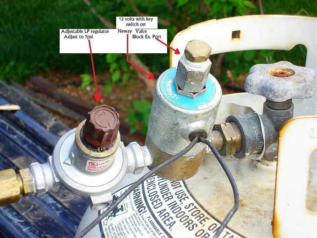

I used the standard air Neway valve, it was available to me and you can purchase these on EBay for about $20.00, you probably should use an electric valve like the ones used on forklifts, they are spendy and are probably safer. If you use the skinner valve you will need to block the exhaust port, now I thought this would lock up the valve and prevent it from shutting off, but seems to work.
I bought an adjustable replacement LP valve from Menards……… Wal-Mart, Home depot Lowes, etc. have the same thing, they are $18.00. It appears the one on your grill will probably work just fine, the pressure we want is about 7psi and that is what a standard grill uses, for a pickup it is fine for a semi you would want an adjustable one for greater flow.

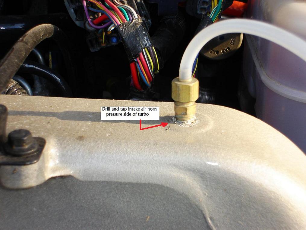

The brass fitting going into the intake side of the turbo is just a brass fitting and use whatever fitting you want and I just filled it w/solder and drilled a .040” hole through it, this is important as it is the metering system for the amount of LP getting into the engine. A couple dollars for this from any auto parts store, hardware store, etc.

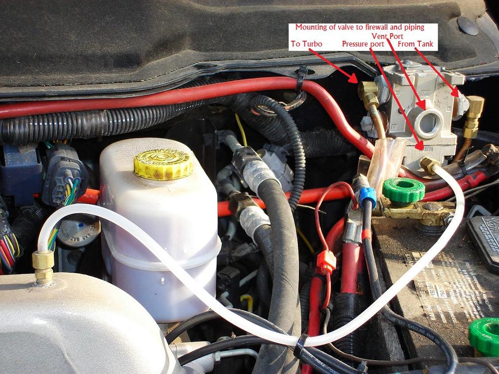

Installation: I use a standard 20lb LP grill tank for the fuel supply and mounted it in the left rear corner of the truck box. I used a ratchet strap to secure the tank to the box using the tie-down spot in the corner. I ran wire and copper tubing from the front under the hood of the truck to the rear were the tank is mounted. The Neway valve is mounted to the tank and adjustable LP valve is mounted to the Neway valve. I hooked the 12v wire to key power and copper tubing to LP valve. I mounted the hyd valve in the engine compartment on the firewall and ran the plumbing to the engine as pictured.

Thanks for posting this. I am guessing that the clear plastic tube from the air horn to the bottom port on the gas valve meters the gas being delivered to the input side of the turbo.

Let me explain the pilot operation of the hydraulic valve better than in my original post. The normal hydraulic valve that everyone thinks about, operates by your hand on a lever, the movement of the handle moves the spool inside the valve. The more movement of the handle/spool, the more fluid is allowed through the valve, the more work being done. Pilot operated means the movement of the spool inside the valve is moved remotely, in this case turbo boost pressure. The plastic line going to the bottom of the valve has turbo boost pressure and this operates the pilot portion of the valve.......so the more boost pressure the more the valve moves the more gas is delivered to the motor. This is especially helpful with in town driving as well as highway when turbo boost pressures are highest. The valve is set to deliver LP at 3+ psi turbo boost since we want none at idle. Hope this clears it up some.
