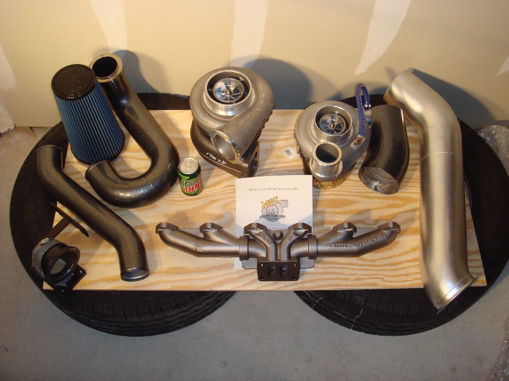

Two weeks ago, a couple of large boxes show up at my door from MPI. I open them up and find a big 62/71/13SS turbo, an even bigger S400 turbo (this thing is huge)

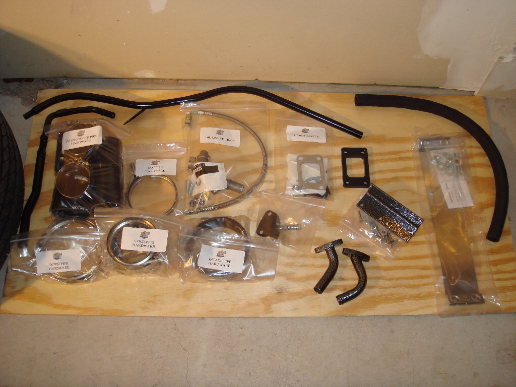

, perfectly welded and powdercoated hot/cold pipe, 5" downpipe, a box of labelled fittings/hardware, and everything else needed to thow these bad boys in my truck, including a detailed set of instructions. I was like a kid at Christmas!

I was busy the next few days with work and family stuff, so I wasn't able to really get back to it until Thursday night and Friday. The instructions were self-explanatory so it was just a matter of following the directions step-by-step. I decided to go 5" all the way back from the turbo, so I also installed the ShopDiesel exhaust as well as a 51" Donaldson.
After installing the exhaust and admiring the newly installed twins, I could not wipe this huge grin off my face. This spot in the engine bay is absolutely perfect for a set of twins. Nathan's kit goes together flawlessly and they just look like they're supposed to be there!
