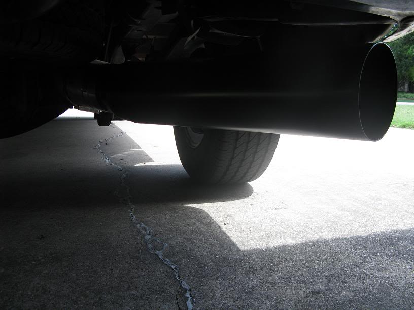

Some of you may think the tailpipe is too low; however, this is how the kit came, I'm sure this is more suited for the 4wd as is. For the moment I like it how it is, mainly because I would have to drive 80 miles round trip just to get that 5" bended up some. The fitment is right on par, but the pipe cant be adjusted anymore without hitting the axle.

You can rotate it at that last bend a little to get it angled back up some, I didnt like the look so I made my own "tip". Its 6" pipe and the transition is back by the rear end so you cant see the transition and I welded it at a slight angle back up so it would tuck up more to the bumper....
mine was the same way

Pooter, yep looks like we are on the same page. Undecided on a tip, but I know the pipe will have to come up some. We got it adjusted as high as possible without changing the angle of the tail, dont want it to look like its not level and still want good drainage when I get water in there... so in order for me to get it raised I'm gonna have to get it bent or do a tip.
