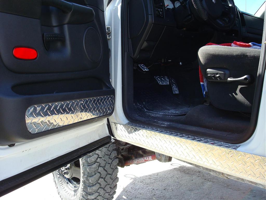

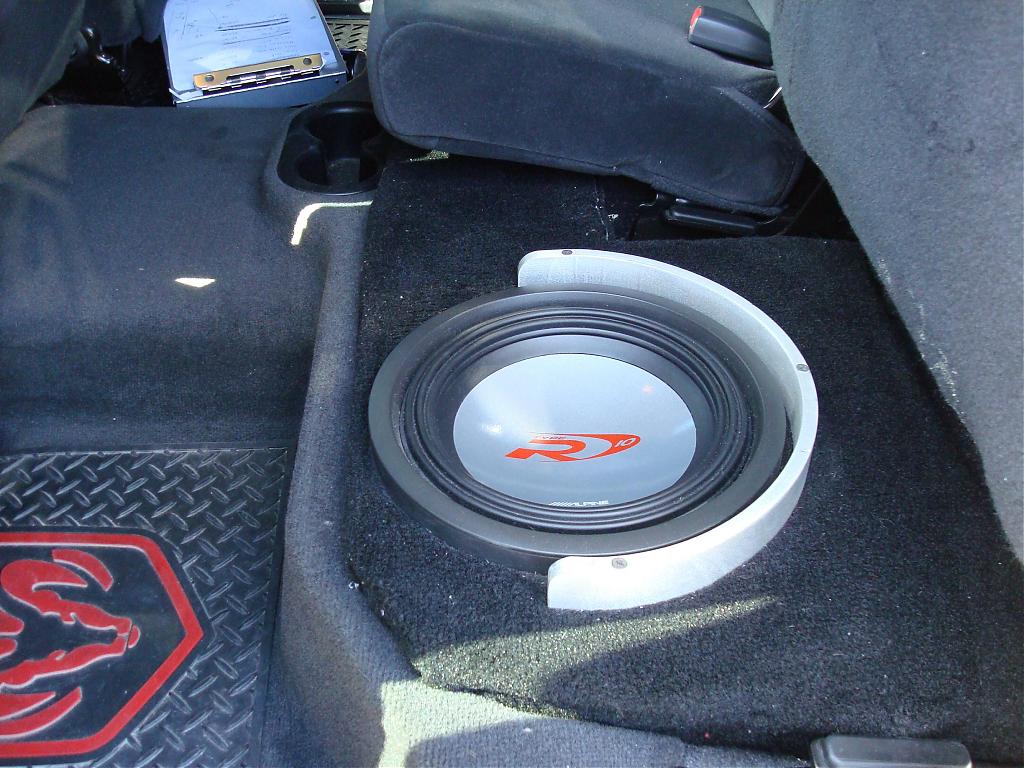

GOODEYSNIPER75 here are some interior pics of the interior and frame mods.

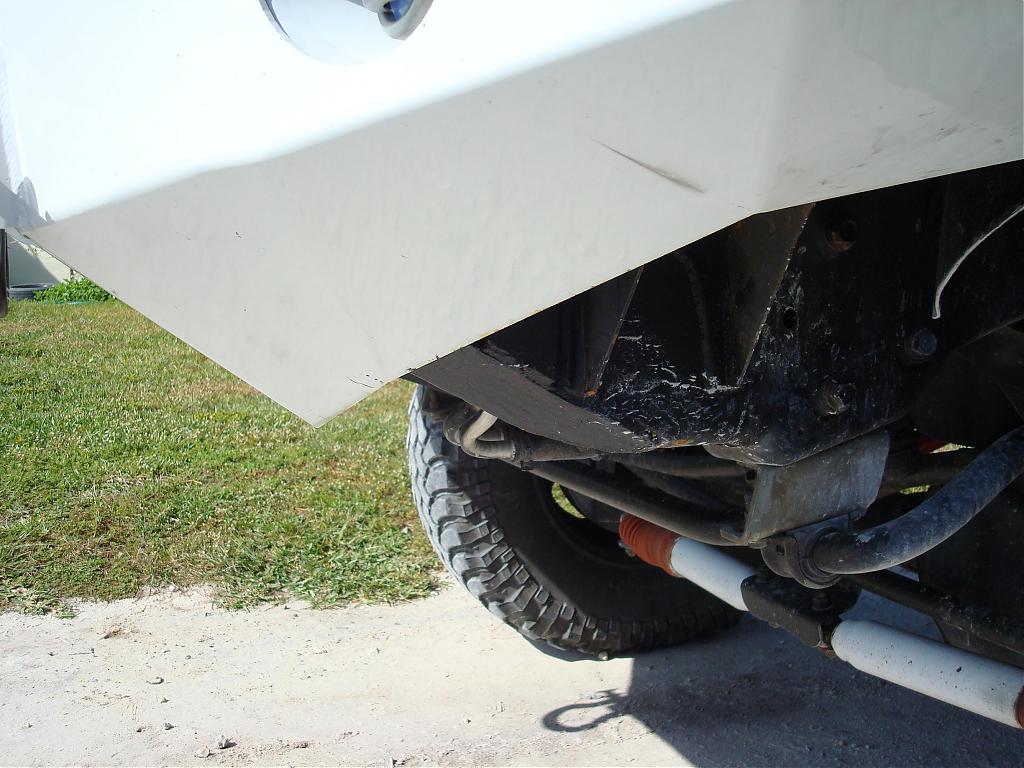

Also i was not impressed with the mounting plates ROADARMOR sent with our bumpers so i welded in big gussets was your mounting hardware that puny 3/16 plate??

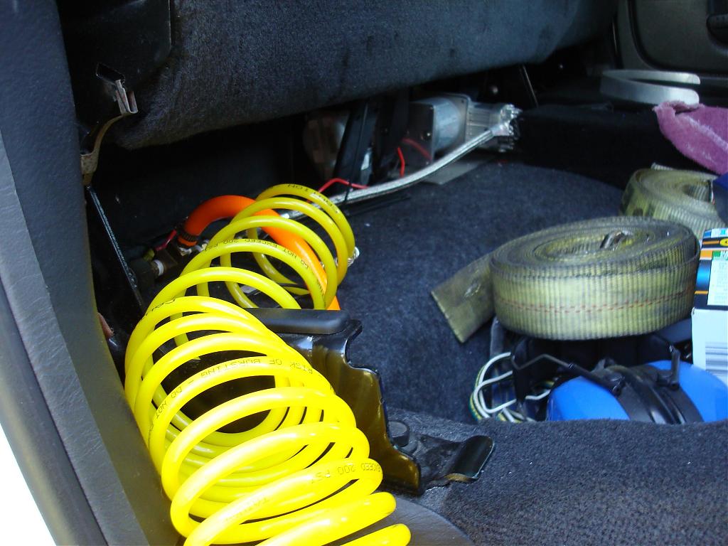

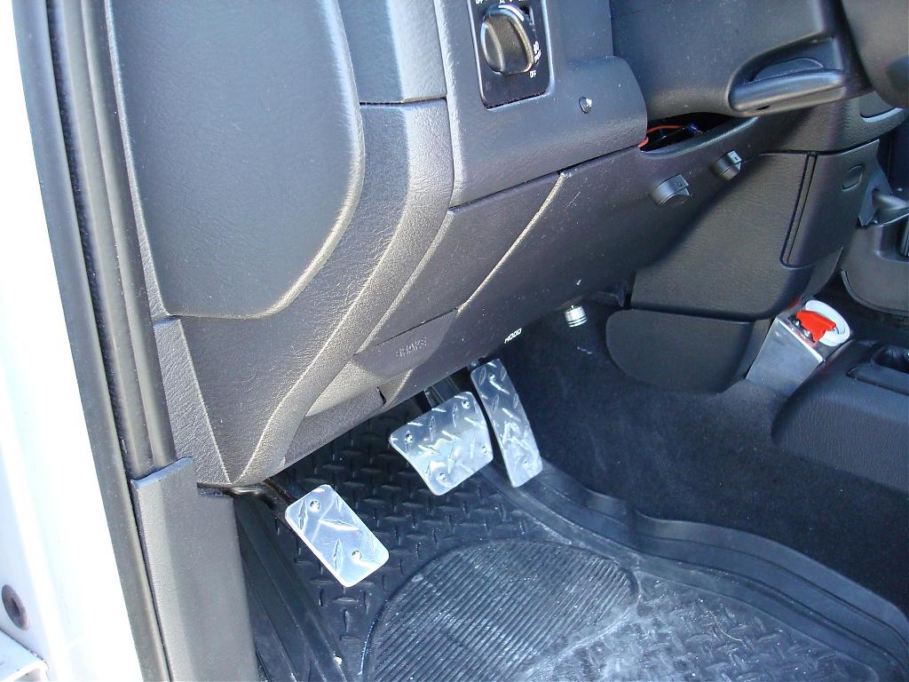

Pics are all the diamond plate accents i made plus my homemade speaker box and a pic of my 100 psi air hose outlet in the cab.

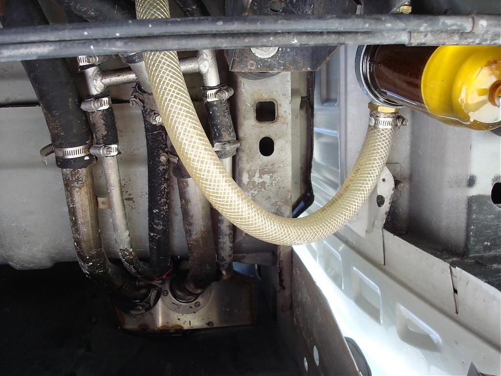

For STACKED97 & FERSTUS

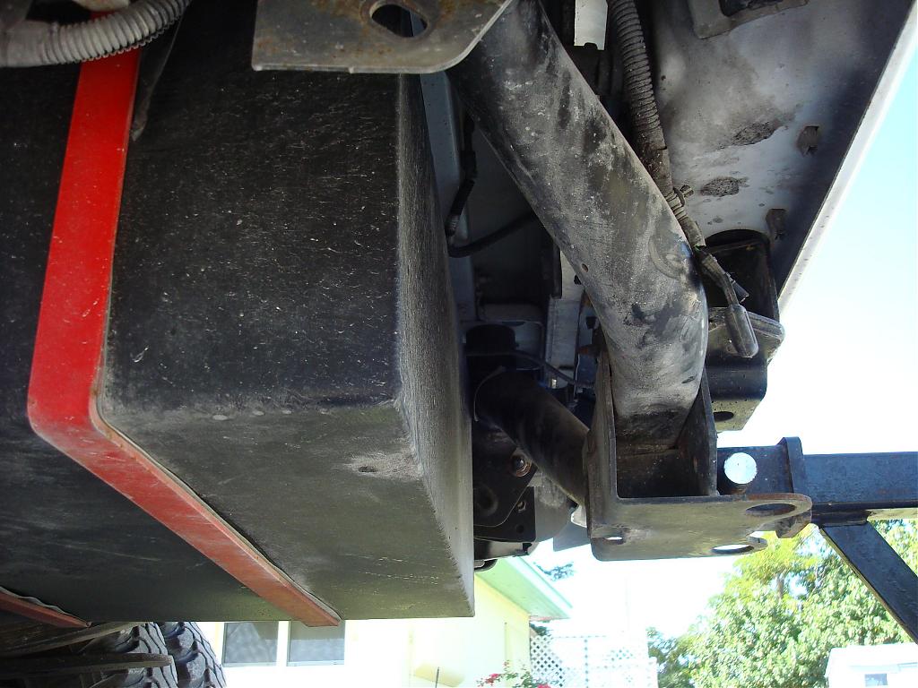

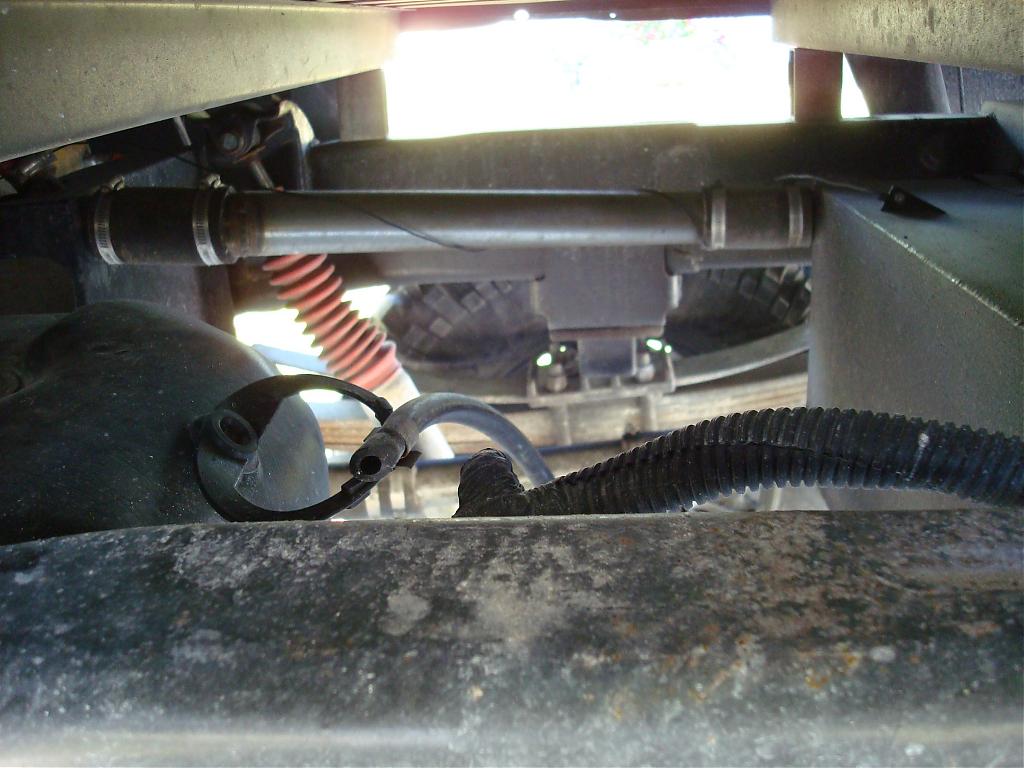

heres the tank info
Hope these pics help and no the rear tank does not effect the stock hitch I use mine all the time. You can see how i connected the tanks to each other just like in a boat 2" hose on top and bottom keeps them the same level. There are a few bafles in them for sloshing. Just a simple swich in the cab for your transfer pump and i have an extra fuel guage. You can see how i connected the vents together and then ran a 3rd vent up into my inner bed so i can tranfer with no problems while driving. Only compalint is our dodge fuel guages take so long to read the 5gpm pump fills the stocker way faster than the stock guage will read it. Hope this helps yall le me kjnow if you want pics of somthin else. Also it rides allot smoother with 7 or 800 pounds of fuel in the tanks.

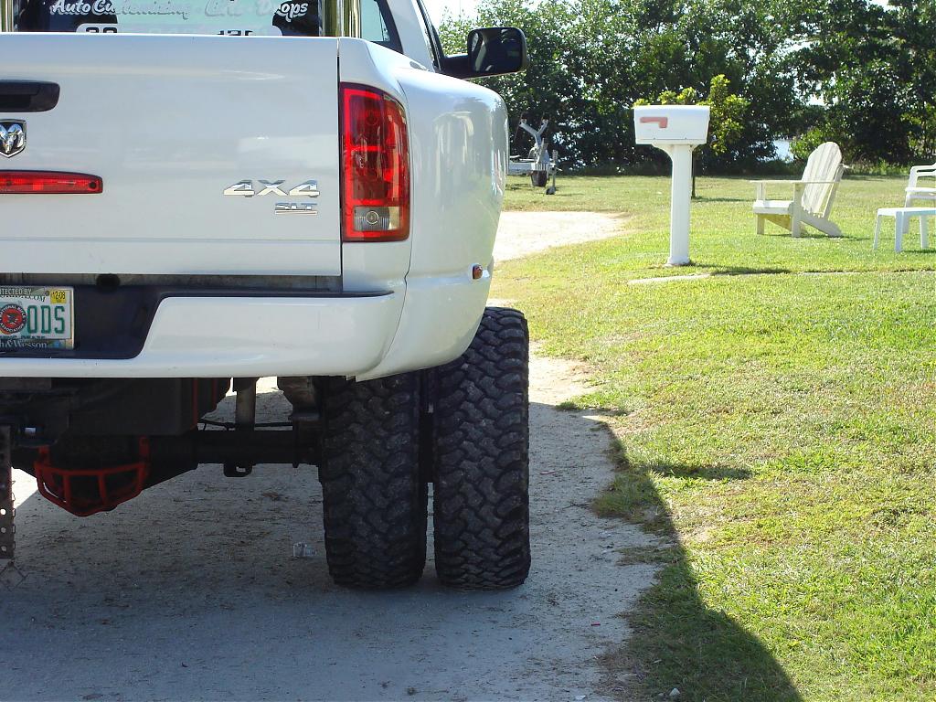

I was thinkin of addin a 3" leveling susp kit.... the kit with the shocks and stuff, I was thinkin of going with a 317/75 and 2 " spacers...... I was wanting a pic to see how much that the rear tires stuck out past the fenders

my mounting hardware seemed plent strong, but i would have to go look to see what size....i like the inside... looks sweet...

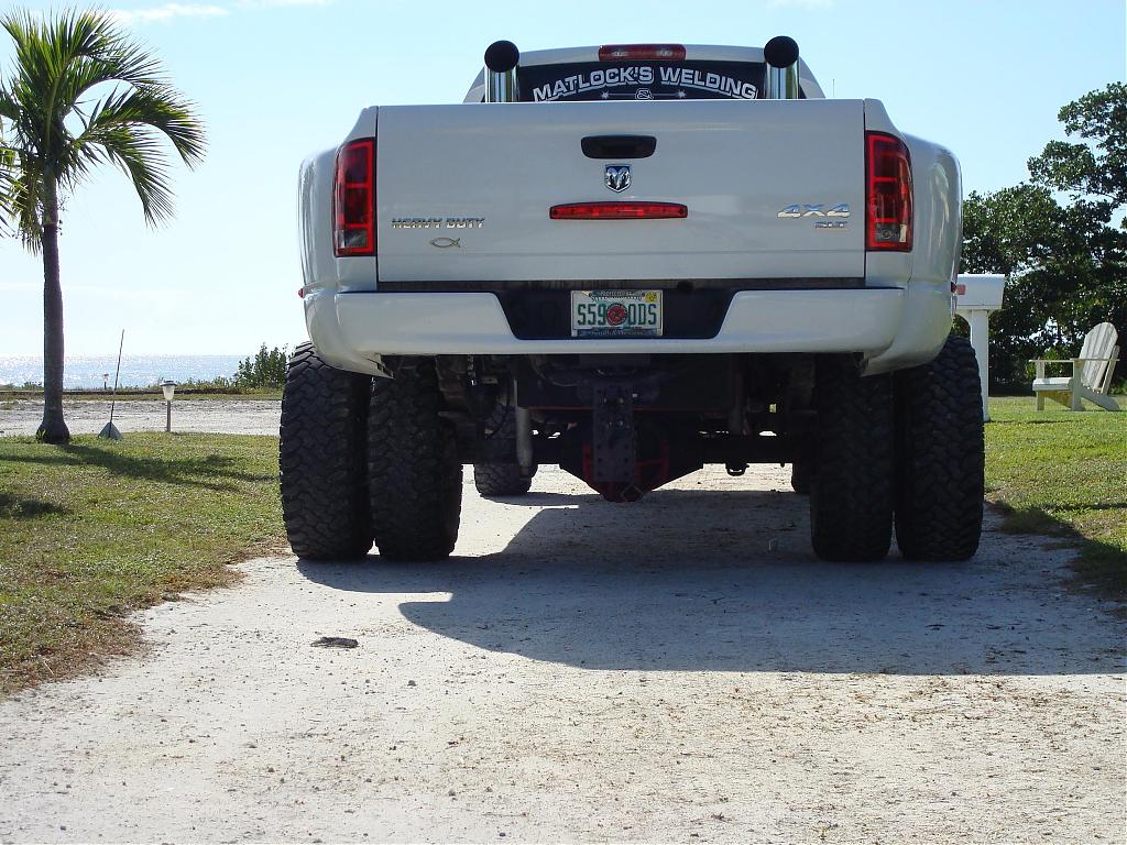

Here are the piccs of the rear wheels for ya They dont stick out that far but it looks so mean. They throw allot of water in the rain but i love it. Just make sure if you get spacers you dont gt those aluminum ones they should not be allowed to be sold billet steel all the way.
