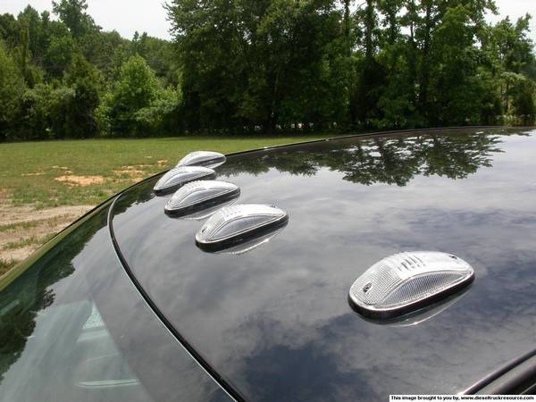

Got'em on there I smoked them myself and it looks really good I was a little worried about them not being bright enough after smoking them but they look really nice and are plenty bright. I put some LED's in there but they were to directional and didn't light the whole light so for now it is just a regular bulb. I will post some pics soon. The headliner is a PITA! And the instructions are not very clear which wire to tap into on the 06's but I got it done. YEAH! And I like'em...

Here's a picture of the Recon Smoked lights. I think the only diffrence is the bases are black instead of chrome.

here is a picture
https://www.dieseltruckresource.com/...G%5D%5B/URL%5D
It is raining i will try to get a better picture when it is clear out and oh yeah they DON'T leak!
