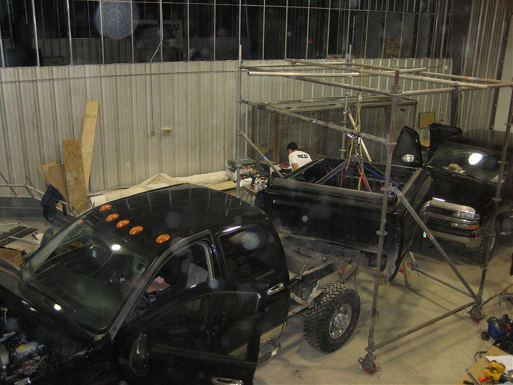

Old Feb 10, 2009 | 04:39 PM
kprc51's Avatar
Posts: 148
From: Winnipeg,Manitoba
it helps to have a buddy who works for a scaffolding company.
