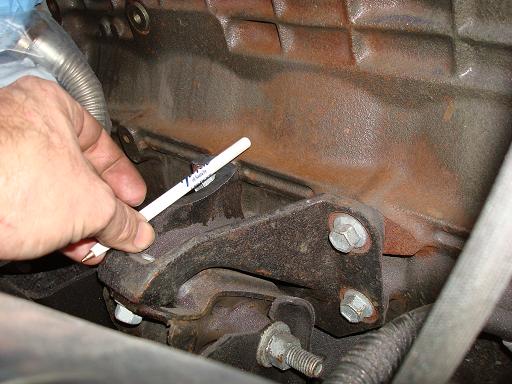

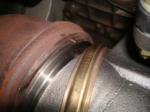

Final tips I learned the hard way for first timers.
1. There are two small pins sticking out of the stock downpipe. My aftermarket turbo didnt have holes for them so I had to grind them off. I noticed this after I put the turbo and manifold in place, had to pull that heavy thing out.
2. Manual wastegate diaphram might hit engine mount, I didnt realize this until I put the turbo and manifold back in place, had to pull it out again and grind on the mount.
3. The downpipe might try to push forward on the assembly making bolting it up hard. Get on the ground and push around on the catalytic to move the downpipe around.
4. On autos, at least on my 2006, the trans dipstick tube sits against the downpipe keeping it from moving. You can loosen it by unbolting the bracket on the trans bellhousing from below, makes it easier to get the vband hooked up to the turbine outlet/downpipe.
