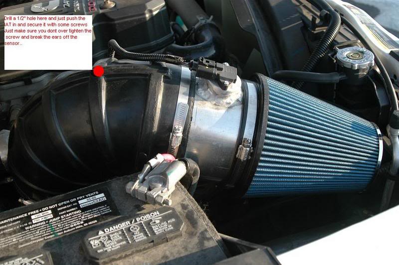

Homemade 6" Air intake, AKA the "whistler", tech write-up

all the AFE intakes I looked at are plastic and they graduate down in size as you go to the turbo just like mine. (the AFE may even go smaller quicker then my set up) I dont think my rubber elbow's are going to muffle that much sound
I'm happy with the $85 bucks I spent.
I wish you could hear mine, I'm telling you it's LOUD!!

53 ******,
I believe that you are right about the 'new' AFE Torque Tubes being made of plastic. However, when I bought mine, they were metal.
The one I have has a rubber elbow that goes from the turbo intake to the bottom of the TT. Where the TT connects to the AFE filter mount, there is another rubber sleeve.
I'm not, at all, suggesting that your set-up doesn't sing beautifully. Just relaying a major difference in sound when I installed the metal TT on my system. I'm not positive that the metal has that much to do with the increased turbo sound. I'm 'just guessing' that the metal does not soak up as much sound as plastic or rubber.
Quite frankly, I'm very impressed with the system that you created. You're ability to 'fabricate' is, certainly, much greater than mine. You got the pleasure of building it yourself & the benefit of money saved. Not a bad deal!!!
Thanks for sharing your creation & for providing pictures, also.
Joe F.(Buffalo)

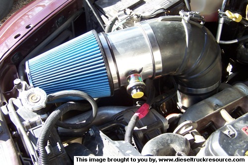

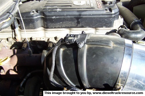

Finally got a day off work today and got it installed this morning. I was really surprised how easy it was to install. Here's a pic-
Let me tell you, TONS OF !!!!!!!!!!!! Sound like an F-18 taking off under the hood. For the money, I don't think there's a better set-up.Talk about bang for your buck! I just wanna thank 53willys for the idea and technical advice.
P.S. 53, please post up when you get the box built, as I'll be watching close. Always looking for shade-tree projects!
NIce job Dixie!!!!
I will keep you posted on the box and another little trick I came up with soon.
as far as performance goes it seems to spool the engine a little more freely and the EGT has gone down 75-90-degrees while cruising on the freeway. I have not had a chance to tow with this intake yet.
